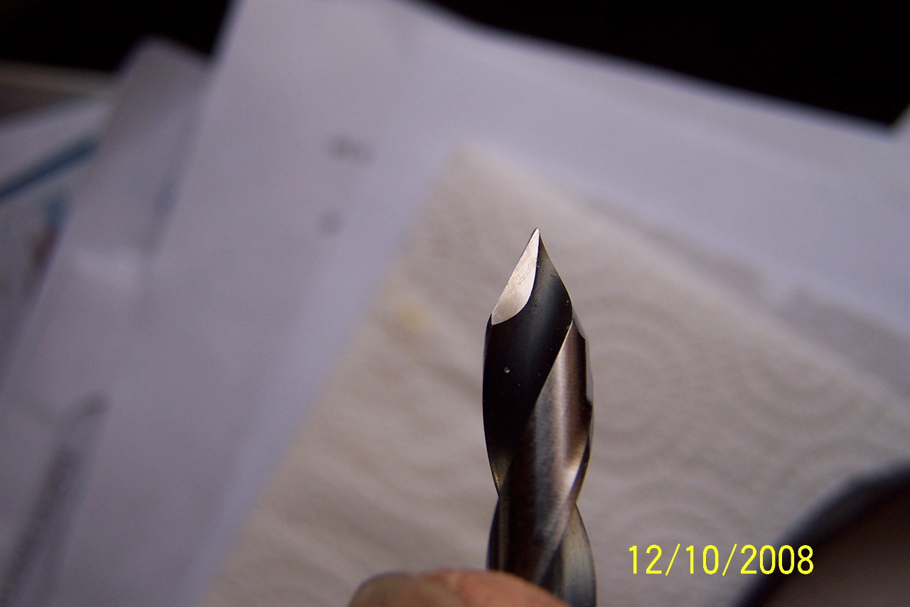

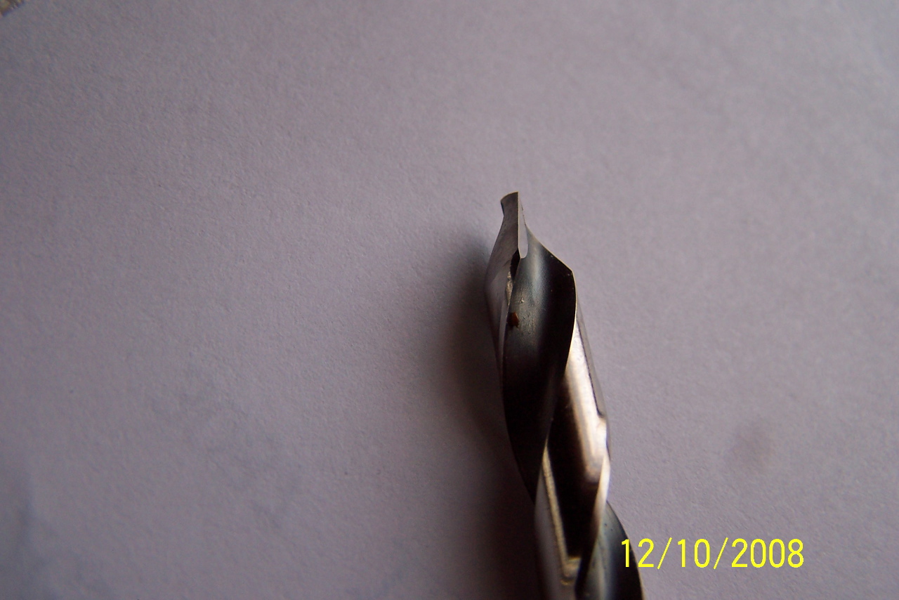

I just checked mine, Gary, and the included angle is 54°...pretty
steep compared to the normal 118° angle of a drill bit for steel.
Also, the cutting edge needs to be flattened so that it does not cut
into the material, but scrapes it instead. Here are a couple of
pictures of the ones I got from LP Aeroplastics.
Lynn

A common step drill works just as well as the LP Aero acrylic bits
in my experience. I have drilled a lot of acrylic with it, and never
had any problems.
I do have a set of the LP Aero bits, but I don't think they offer any
advantage over the step drill.
Jeff
