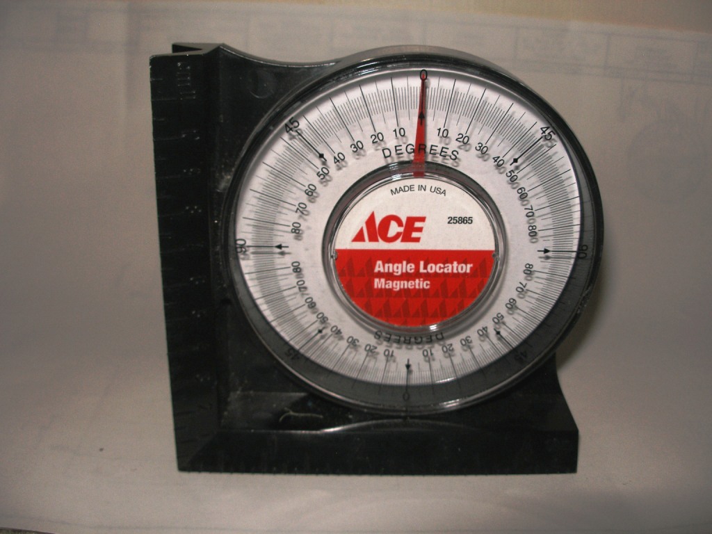

For setting angles, there are devices on the market (photo) that have a hanging weight physically tied to a dial indicator that shows the angle. Gravity is not electronic nor digital and is very reliable. Just make sure and verify the accuracy of the pointer before using it.
Jay in Dallas
