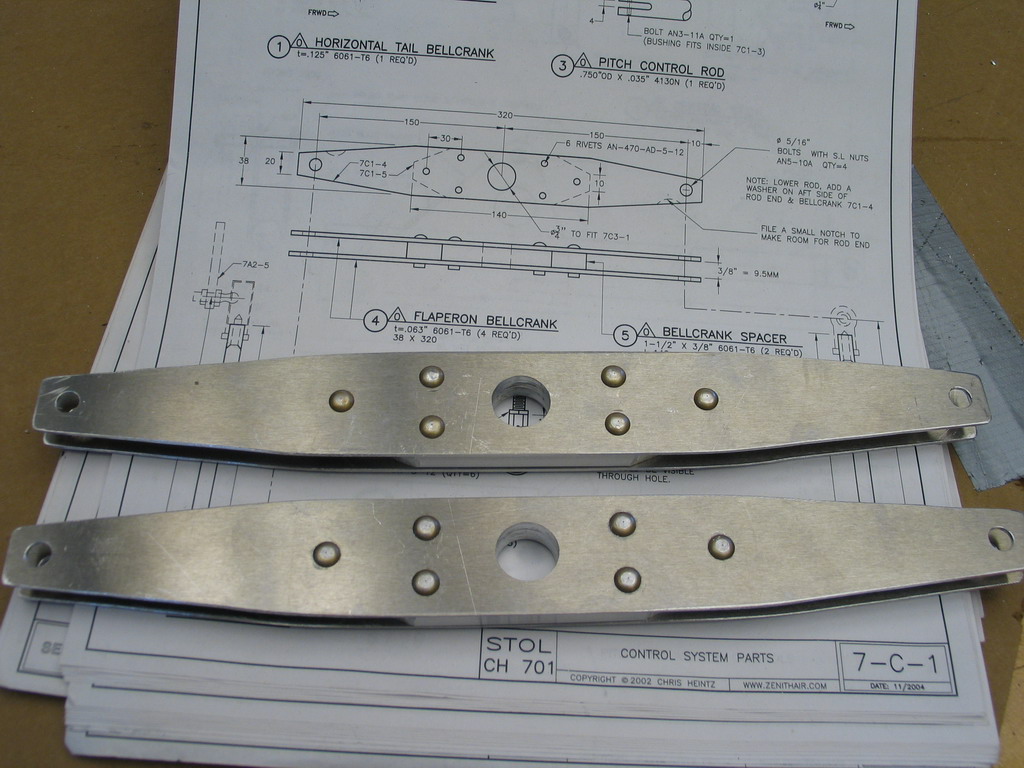

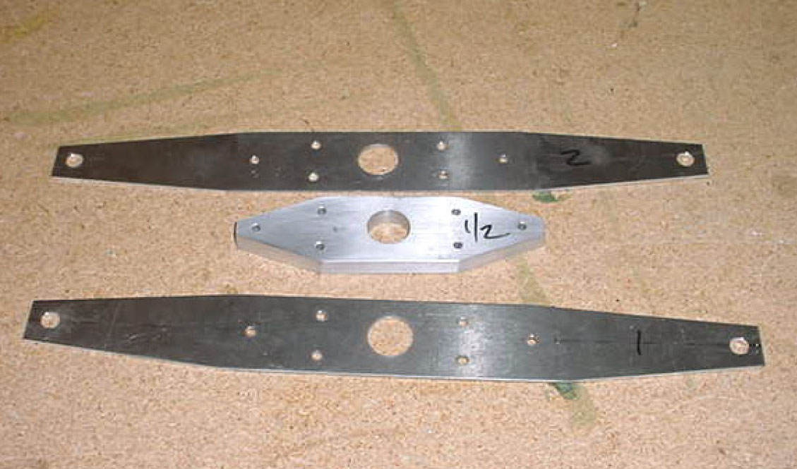

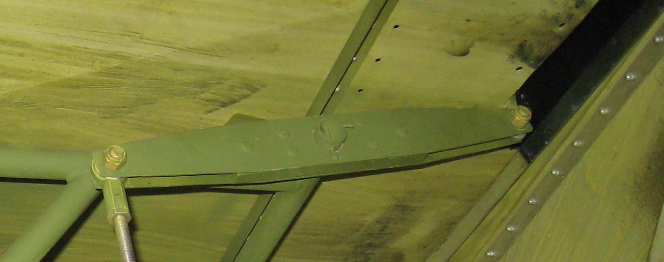

I don’t have exact dimensions but I’ve attached pictures from three different sources. P1 and P2 are from the Zenith photo guide, P3 is of my plane and P4 is of George Race’s. Hope this helps.

The plans seem pretty vague on page 7C1. I was wondering how other people have placed the rivet holes in 7C1-5 and trimmed the piece.
First I guessed that to angle the piece that 30mm in on the sides seemed right with the holes 10mm in from each side. Further interpolation made me place the two holes 30mm out from the center. The big question is this: Are the four holes placed 10mm in from the edges?
Does this seem right?

I have not built that part yet, but from the way its drawn I'd say that the outboard rivets are a good safe edge distance in, with respect to 1C7-5 and the inboard ones are 30mm in and the same good safe edge distance from the edge for both 1C7-5 and 1C 7-4.
