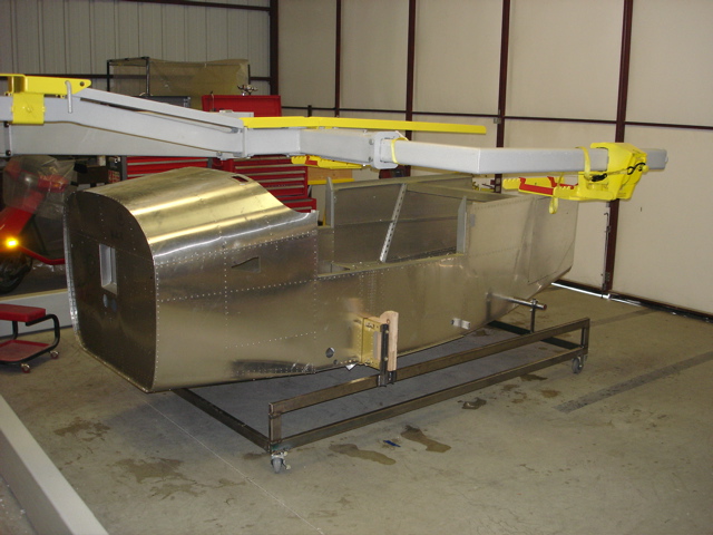

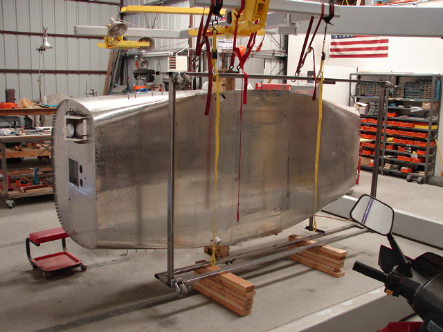

Here are a couple of fotos of the stand I built. I use my aerolift to turn the stand on it's side, which allows me to work on the fuselage without leaning over. This is a real back saver! 2 people can easily rotate the stand without a lifting device. It cost about 30 bucks in thin wall 1X2 steel and a set of cheap casters.
Chris Hukill
cabin top hell

I don't know whether it has been mentioned but a wooden dolly on wheels from home deport aviation department under each wing attach point and one under the baggage area works fine . Total about $40.
