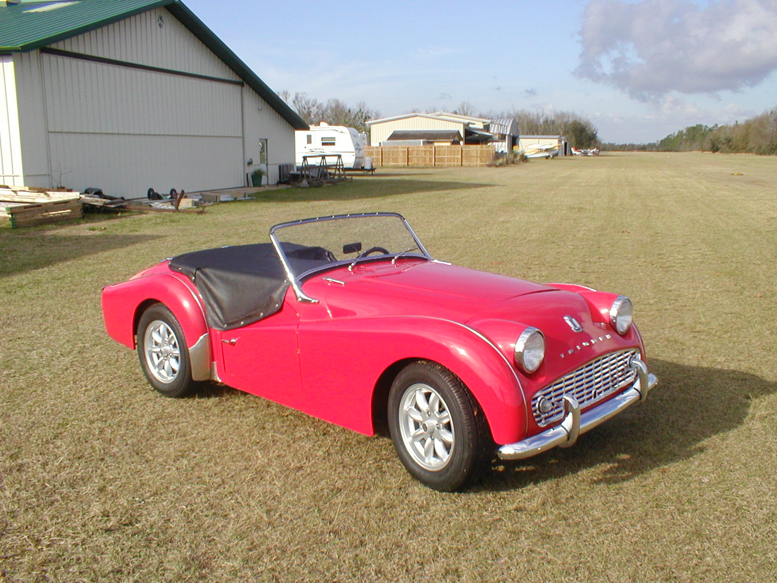

Dick Maddux
Joined: 24 Jun 2008 Posts: 516 Location: Milton, Fl
Posted: Fri Jan 16, 2009 4:18 am Post subject: Bing Carbs |
Triumph Tr'3s have never had Bing carbs ( they are SU H6) I bet you knew that was coming.

daveaustin2(at)primus.ca Guest
Posted: Fri Jan 16, 2009 6:56 am Post subject: Bing Carbs |
Right on,Dick! But they sure looked the same, and worked the same..

Float Flyr
Joined: 19 Jul 2006 Posts: 2704 Location: Campbellton, Newfoundland
Posted: Fri Jan 16, 2009 11:03 am Post subject: Bing Carbs |
I think your Healey 3000 got shrunk... Beautiful machine!
Are the wheels original?

Dick Maddux
Posted: Sat Jan 17, 2009 4:56 am Post subject: Bing Carbs |
Thanks for your kind replies on my Tr3B.( I also have a "cherry " TR3A and a Stag) The wheels are Panasports and were offered as an option. And as you said the SU carbs are very close in function to the Bings. When I went through Rotax school at Lockwood we tore down the Bing carb and reassembled it. The Bing has more parts but its function is almost identical to the SU so it was easy to correlate.
