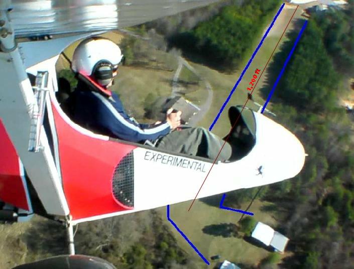

I do exactly the same thing but I also lock my brakes "coming in" with a tail wind or over stall speed.
You will not nose over with that kind of air speed over you tail, especially over grass, it will shorten your landing
and will prevent you from bouncing or floating when you don't have the runway length to spare.
It took me 5 or 6 years to figure this out. We've got a short field, so it doesn't apply to most of you guys.
Unless ........
I'm landing on this video with a 5 - 10 mph tailwind (at)35mph air speed -
only one way in and draggin brakes all the way on the grass.
[url=http://video.google.com/videoplay?docid 63159682459782825&hl=en] http://video.google.com/videoplay?docid 63159682459782825&hl=en[/url]
