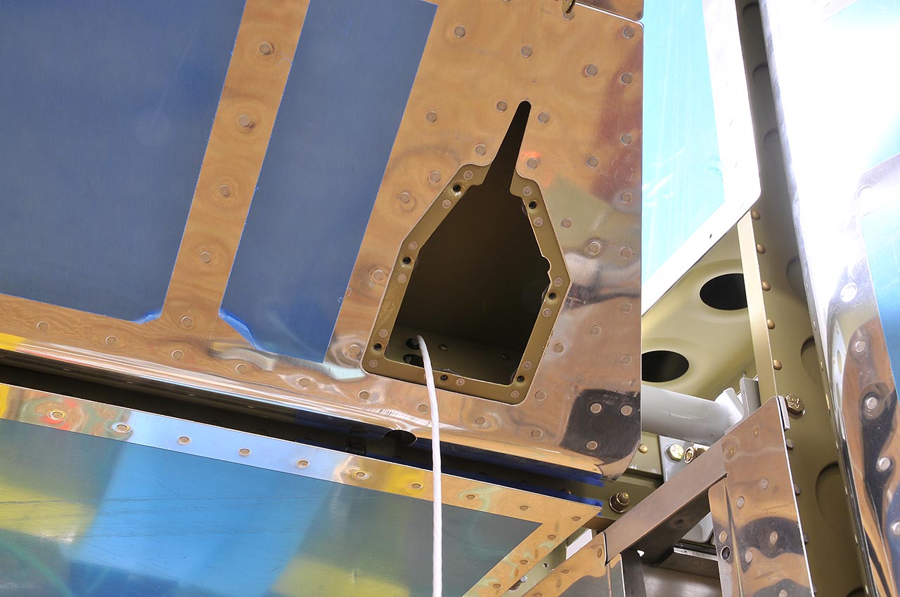

Greetings:
Looking for a better solution than routing the Trim Tab Servo wires thru the hole in the Elevator Spar (where the long Servo Motor Screw goes).
Does anybody have any pictures or diagrams of the Wire Routing of the Trim Tab Motor wires in the Elevator to the Horizontal STABILIZER to the fuselage.
Not much given on this subject on Matronics.
Thanks, Garey Santa Monica, CA

Hi Garey,
I just did this task. I simply drilled a 1/4" hole above the servo screw hole and added a little black plastic bushing. Attached is a picture.
