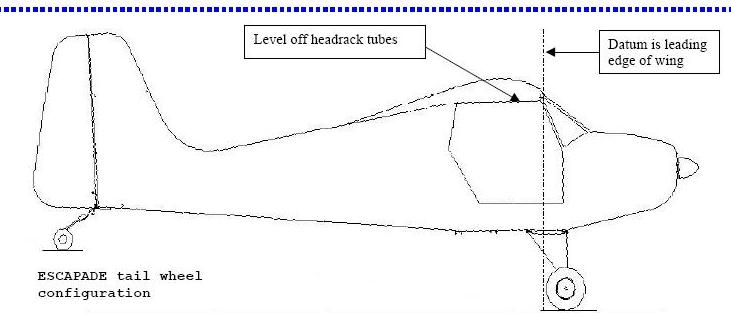

Hi!
Someone knows which is the distance from DATUM line to "center of wheel" in Kitfox Model IV ??
See jpg attached of Highlander (www.justkitplanes.com)
I need the same image of Kitfox IV, to find answer to my question.
Can you help me?
Tks
FD
Can you help me?
Check out the photo of Bruce Hoisington's Series 7 KF with what appears to be Grove gear.
<http://www.kitfoxaircraft.com/images/Recent%20Completions/BHoisington.htm>
It looks like the gear is mounted about where yours is, slightly behind the datum
(leading edge of wing).

The 'Most adverse forward" on your sheet should be labeled 'Most adverse aft". Doing some quick and dirty math with the 154 pound pilot, 30 pounds fuel and no baggage, I calculate a "Most adverse forward" CG of 12.0 inches and gross weight 1069 for your plane. With these numbers the axle is still only 3.74 inches forward of the CG.
To compare, my Classic 4 axle center line is 2.5 inches behind the datum and the forward CG limit is 10.2 inches. Axel is 7.7 inches forward of forward CG limit.
My actual calculated most adverse forward CG is 12.3 inches at a gross weight of 796 pounds. The axle is 9.8 inches forward of CG.
Your plane will also have more inertia due to the heavier gross weight. Just a little too much brakes or a gust of a tail wind and your beautiful plane will be on its back.
I would not taxi until this condition is resolved.
Tom Jones

PostPosted: Tue Jan 27, 2009 7:45 am    Post subject: KF IV Distance from DATUM to center of wheel Reply with quote
Lowell:
I just ran a couple of calculations and I think he needs to move his main
wheels ahead to position 3.21 in. aft of datum to provide 45Lb. on the tail
wheel at empty weight.
I think all aboard will agree 15 lb is way too small a weight on the tail
wheel for a close to 900 lb. plane. In the mean time he should keep his
feet off the brake pedals.
Just for the fun of it my calculations started with
45lb on the tail (at)151.8in. = 6831 an increase in moment at the tail of
4486. This moment to be subtracted from the total of the main moments.
(3610.28+3573.85)-4486 698.13
I then subtracted the 29.55 lb added to the tail from the total of the front
wheels. (437.08+432.67)-29.55=837.2
Finally 2698.13/837.2= 3.22 that is just about a full five inches forward
from where it is now.
Truth is because the landing gear itself has weight it will probably put
slightly less than 45lb. on the tail wheel.
Noel

PostPosted: Tue Jan 27, 2009 8:07 am    Post subject: KF IV Distance from DATUM to center of wheel Reply with quote
Paul,
That is the problem I find with math. The typical weight if the Grove gear
including fasteners and axle is 30 lbs and that was on personal inquiry from
Grove. In my head you would be moving a 30 lb. wt. forward about 10 inches
or so by my guess - no math, just looking at my uncovered fuselage and where
his gear is and where mine is.
Regarding the 55 lbs. That was calculated based on my tailwheel wt. vs.
gross wt. and my airplane flew fine with full three point elevator
authority. Lynn Matteson said his tailwheel wt was in the 55 lbs. range as
well and that was at 6.25%. Maybe it is time for another survey Smile.
Lowell

PostPosted: Tue Jan 27, 2009 8:34 am    Post subject: Re: KF IV Distance from DATUM to center of wheel Reply with quote
I did some "What if" computer weight and balance assuming 50 pounds for the landing gear. With Francisco's weight and balance numbers the 50 pound gear can be moved to zero inches from the datum (at wing leading edge) and it moved the empty weight CG only about a half inch forward.
I think there is room in the numbers to move the gear forward enough that the tail weight will take care of its self.
Tom Jones

PostPosted: Tue Jan 27, 2009 8:57 am    Post subject: KF IV Distance from DATUM to center of wheel Reply with quote
If wing cord is same on BrazFox as Kitfox wheel should be at same distance
from leading edge of wing.
(datum is something that can be placed any where, but is convenient to have
on same place as other of same brand.
Jan

PostPosted: Tue Jan 27, 2009 8:59 am    Post subject: KF IV Distance from DATUM to center of wheel Reply with quote
C of G is fine for flight. But only having 15 lb on the tail wheel means he
won't have to use very much brake to turn it on its nose.
Especially on a short field landing. One thing for sure he won't break any
tail springs.
Noel

PostPosted: Tue Jan 27, 2009 10:11 am    Post subject: KF IV Distance from DATUM to center of wheel Reply with quote
Re ran my calculations for a 65 lb tail wheel the answer comes out that the
main wheel should be .41 in ahead of the datum. This maintains the current
C of G
Noel

PostPosted: Tue Jan 27, 2009 11:44 am    Post subject: KF IV Distance from DATUM to center of wheel Reply with quote
I just did a search on the web to try to get a handle on what the weight on
the tail wheel should be for similar configured airplanes, if not similar
weight. I checked C-180s and Pa-18s They both have the tail wheel out under
the rudder. They were all around 5.5% of total weight on tail give or take
0.1% except for one Super Cub that was way down at 4.6% and that guy was
having problems with his W&B.
Going by that search, and limited data, I calculated the tail of the plane
should be around 48.68 lb. Give or take a pound or two. To get that weight
on the tail wheel without changing the CG would require the mains be located
2.31 in aft of the datum. I double checked the calculations and that
includes the movement of the weight of the mains. I think he will be safe
by moving the mains 5" ahead. His plane should have the same flight
characteristics but be a lot safer landing.
Any way we want to cut the grass I think we all concur that the mains are
much too far aft to be safe if any braking is to be used. If he doesn't
mind loooooooong run outs and stays away from rough strips the gear that far
aft probably somewhat reduces the possibility of a landing loop as does the
far aft gear on a tricycle gear plane.
Noel
