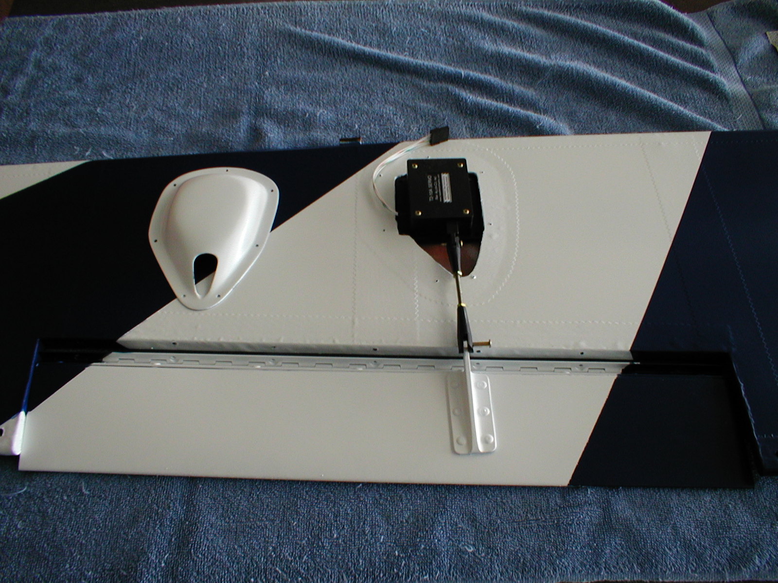

Dick Maddux
Joined: 24 Jun 2008
Posts: 516
Location: Milton, Fl
PostPosted: Tue Feb 03, 2009 5:17 am    Post subject: ski saver Reply with quote
Patrick,
You will love that elevator trim tab of Lowell's ! It makes the Kitfox a new airplane ! I have the trim switch(witches hat) on the top of my stick and use it constently. Flaps never come into play for triming purposes as they used too. Best investment I ever made !
        Dick Maddux
        Pensacola,Fl

PostPosted: Tue Feb 03, 2009 6:52 am    Post subject: ski saver Reply with quote
Dick C Thanks for the picture I am about to leave for the hanger to pick up my elevator. I will tear into it today. I figure the cost will be about $450 give or take a few. What electrical wire did you use and what was the source?
Pat Reilly
Mod 3 582 Rebuild
Rockford C IL
