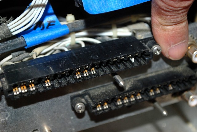

At 09:51 AM 2/4/2009, you wrote:
| Quote: |
Hi everyone,
I was having some noise and tx/rx problems with my nav/com last
fall. I suspect the problem is with the plane's wiring or antenna.
I'ld like to power up the unit off the plane to see how it works all
by itself. I know I must have an antenna connected and I have the
pinouts for the Com card edge connector. I still have several questions -
1) Can someone give me a Digikey part number for the connector, or a
m'fr part number?
2) Would it be Ok to power up the unit without any connections to
the Nav and Glideslope sections?
--Jose
There are dozens of 'card edge' connectors that will
fit your radio for the purpose of crafting a bench
test harness. There is but one connector brand and
style that directly replaces the original harness
connector . . . and a number of styles have been
used on various radios over the years.
Without having access to the manufacturer's parts
list, identifying a second source for a suitable
connector is not possible. Can you post a photo
of the original connector? It would also be useful
to see a photo of the back of the radio. Finally,
confirm the wire-to-wire spacing of conductors
on the card edge.
It is possible that the connector you're looking
for comes from AMP or Molex. Browse the data at:
http://aeroelectric.com/Mfgr_Data/Connectors/Molex_Waldom/
and
http://aeroelectric.com/Mfgr_Data/Connectors/AMP_Tyco/Amp_Card-Edge_Connectors.pdf
to see if you can spot the connector you have in
hand.
Once you've got a suitable catalog number, then we
can probably help you find one or a suitable
substitute.

The connector is an 18 position, double row, with .156" spacing. I'll try to attach a picture below. Looks more like an AMP part than Molex, but for testing purposes I suppose it does not matter. Since I don't want to spend money on special crimpers and insertion/extraction tools, I suppose I would benefit from a type I can solder on to. If you know off hand of a suitable part number, I'll give it a try.
Would it be OK to power up the KX165 without connecting anything to the Nav section?
--Jose

Correction - the Com section connector (P401) that I need is a 15 position connector. (The 18 position connector is for the Nav section, presumably.)
