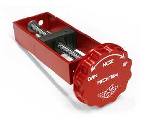

Funny thing is I program, modify and repair automated machinery and the one thing its taught me is simple is better!
Here is what I was thinking of using.

I like the photo of manual trim control mechanism you posted, but my main worry would be how quick changes could be made in case of a " go-around ".
I actually started looking at a system for manually controlling the trim tab to get away from the delay that is seen when using an electric trim controller. I would expect that the one you have just included in your response, might take quite a few turns ( I only have two hands ) to get the trim back to it's take off position.
My past experience ( although limited ) has taught me that when landing in conditions that are not necessarily ideal, my two hand and two feet are very busy, so I would not want to be obliged to have to spend too much time turning the knob one way or the other, to try and get the trim tab, back to it's take off position. However in straight and level flight, the use of a screw type of controller would make fine tuning a pleasure.
Maby it's just me,,,, and thank's for the pic Surprised)

You are correct, it is not a quick adjust model.
