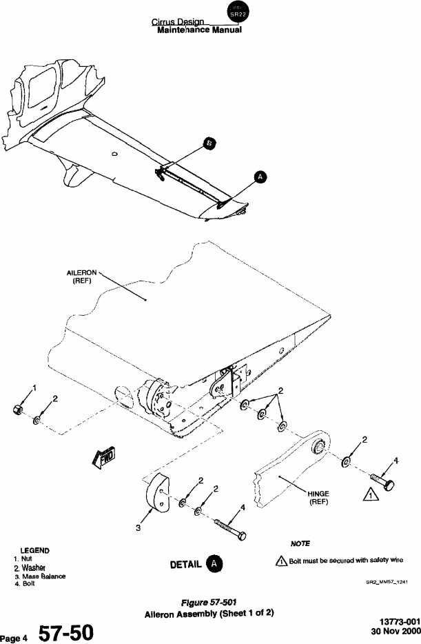

Obviously, Sabrina, the above discussion does not rule out springs in the control system. I agree with Bryan that the SR-20 springs are probably designed to automatically coordinate the rudders with the ailerons. In any case, the attached page from the SR-20 Maintenance Manual clearly shows how the SR-20 (and almost every other all-metal certificated airplane, and many if not most all-metal experimental airplanes) protect against flutter. Yep, it's a counterbalance. There appear to be ~10 mass balance weights on the SR-20 aileron. If you are interested, the SR-20 aileron maintenance pdf downloads automatically from: http://tinyurl.com/dn5ggy .
Why does the FAA require all that testing? Because even the best designs by the best engineers often require fine tuning before they function as intended. It is unlikely that Cirrus' went into production with their first draft SR-20 control system design. Probably the production design evolved as they learned more from GVT and modeling. Do I want to see experimentals & LSA's subject to the same rules as certificated airplanes? Most definitely not! But when experience shows something is wrong, the FAA's rules and reasoning can help lead us to a solution.
Does the 601XL need an aileron mass balance? A good set of GVT plus a 3D model would probably answer that question.
