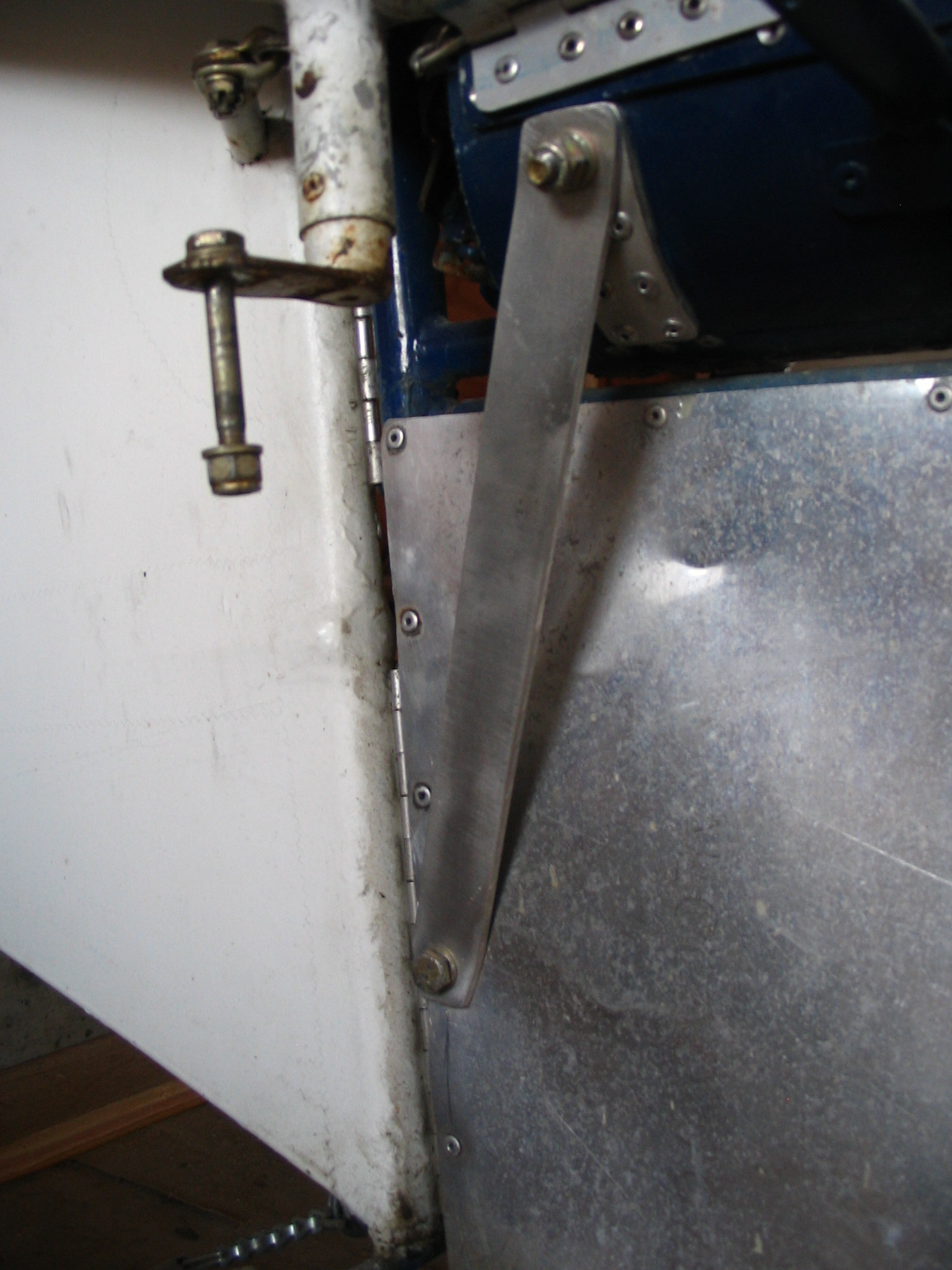

PostPosted: Fri Apr 03, 2009 5:32 am    Post subject: Re: Maule SFS-P8A tail wheel on Kolb... Reply with quote
Mike and others - John H's bracing on tail is nice, and I believe a very good idea. If you look at the pics he posted you'll see one of someone else's plane (looks very similar to his) that shows the bracing done with flat stock aluminum, bolted at each end. I did mine this way and it was simple, and I believe a VERY good mod.
cheers, Rob Cannon

PostPosted: Sat Apr 04, 2009 8:56 pm    Post subject: Re: Maule SFS-P8A tail wheel on Kolb... Reply with quote
Rob,
Can you post pictures of yours !!! I think I get the idea, but I would like to see exactly what you did. This is a good mod I would like to do sooner rather than later.

PostPosted: Sun Apr 05, 2009 7:44 pm    Post subject: Re: Maule SFS-P8A tail wheel on Kolb... Reply with quote
Mike - sorry it took me a while,
Rob
