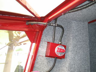

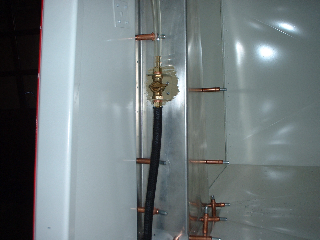

I have also had the smell of gasoline in the cockpit in my 701. I have three fuel valves in the cockpit, one for each wing and one for the header tank.
They all leak a little, enough to cause the smell but not enough to leave a puddle of gasoline on the floor. Attached is a picture of the fuel valve i am using.
[img]cid:FD36852C-616B-4094-8CDC-FE53E48D6C9E[/img][img]cid:FEF9B62D-9119-4A10-B56F-F468264FD667[/img]
Old leaky fuel valve. New Andair fuel valve to be installed.
I intend to change them out soon with the andair ([url=http://www.andair.co.uk/system/index.html)]http://www.andair.co.uk/system/index.html)[/url] fuel valve for the wings,
and hope to find something more solid for the header tank. This is just to reduce the odor, but like Gary Gower says in his mail:
"We have to-admit that -Airplanes have a very pretty smell of gasoline and live with it".
