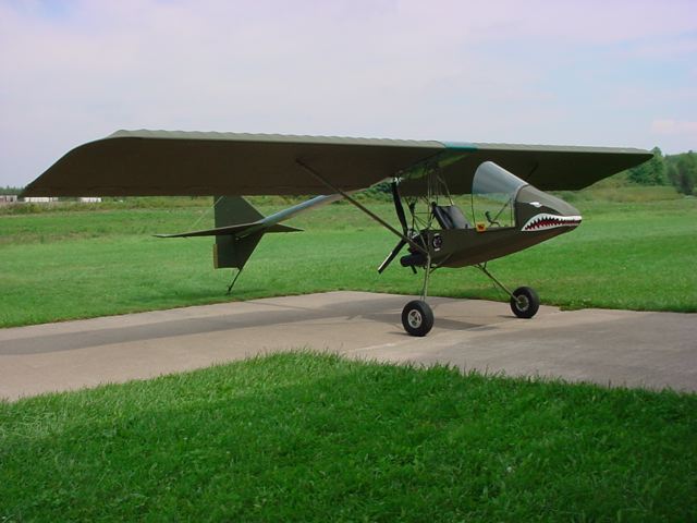

Not always. Ed Steuber's US was fast. Haven't heard from him since
he got a steady job.
BB
ed's ultra
