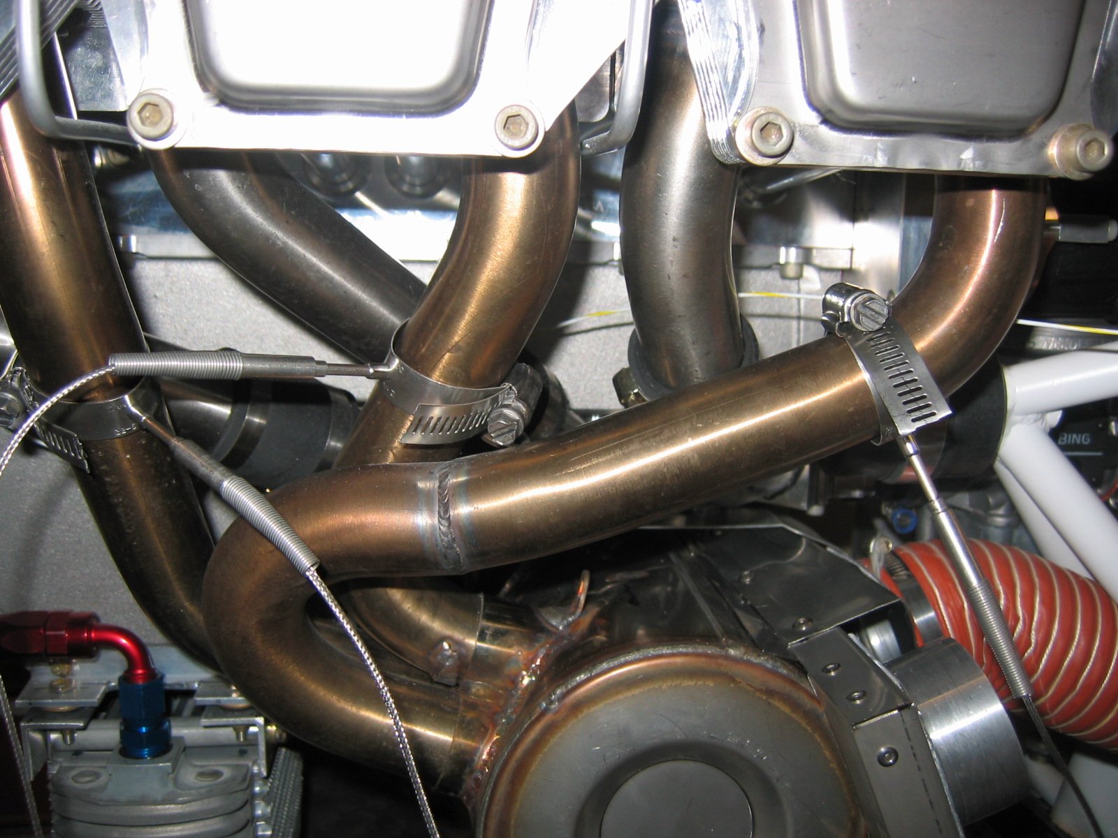

PostPosted: Mon Feb 02, 2009 8:53 am    Post subject: Re: EGT Probe Installation Reply with quote
The installation manual I have, dated 2006, says 100mm is the distance to use for the EGT probe palcement. The Jabiru engine tuning Service Bulletin JSB018-1, dated October, 2007, says to use 120mm. I don't have my Oshkosh notes with me, but I remember Pete K. saying in the Jabiru forum there that 120mm was the new recommended location. I used 120mm on my installation.
Good luck,
 Filesize:  293.21 KB
 Viewed:  1014 Time(s)
David Gallagher
Cincinnati, OH area
