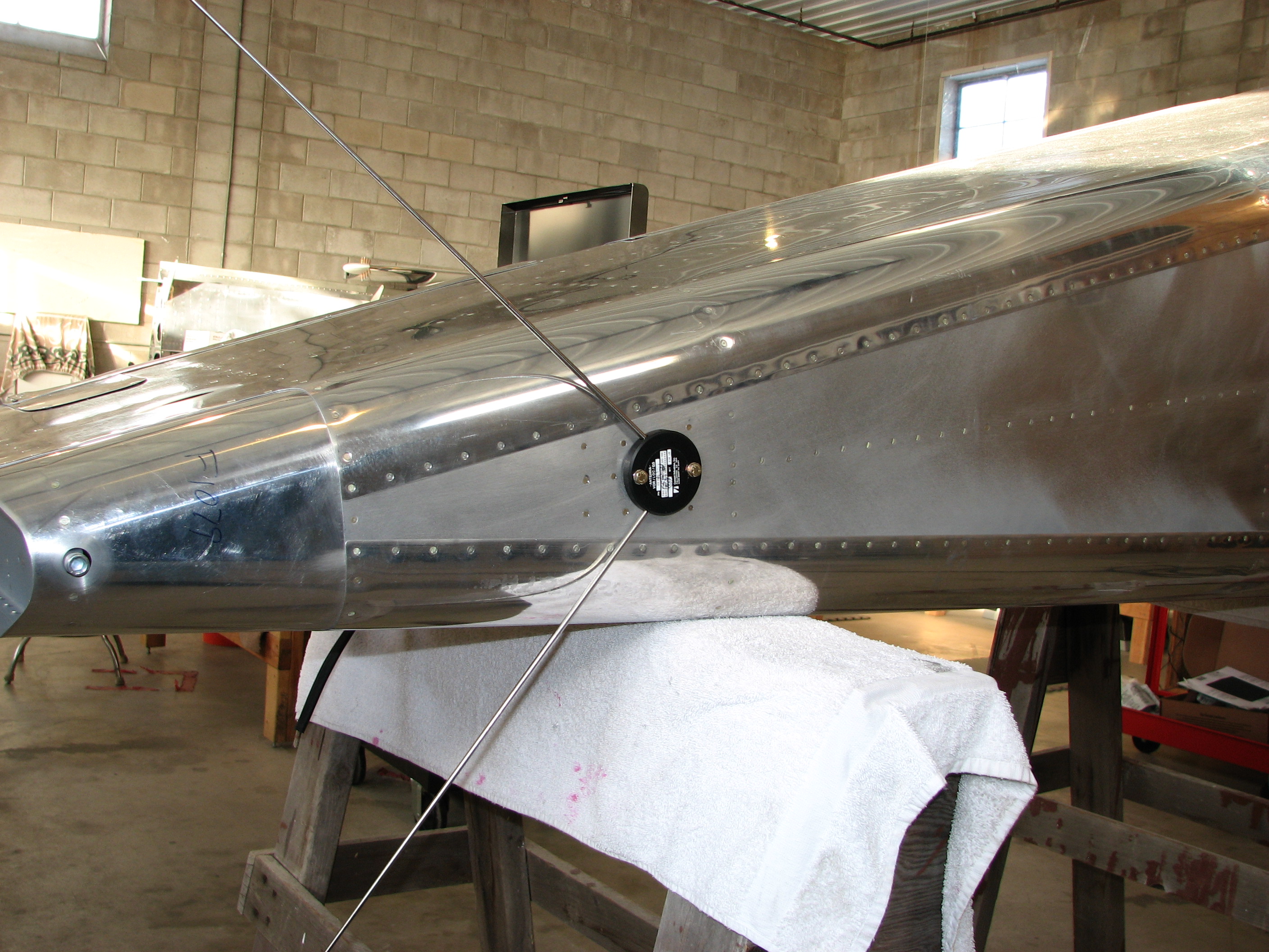

PostPosted: Sat May 09, 2009 10:41 pm    Post subject: Re: Mounting Antennas On Bottom Fuselage Skin... Reply with quote
Here is my installation on the RV-10. Doubler on the inside.
