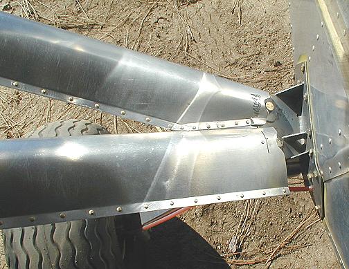

View of the Wing Strut Fairings at the fuselage attachment point.
 Filesize:  56.71 KB
 Viewed:  14342 Time(s)

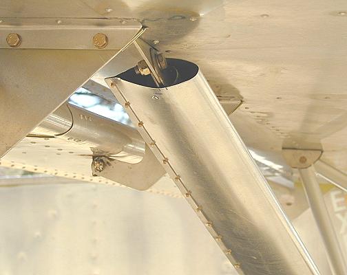

Close-up view of the Wing Strut Fairing around the Factory Round Strut.
 Filesize:  31.45 KB

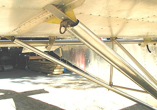

View of the Wing Strut Fairings at the Wing Attachment point.
 Filesize:  45.18 KB
