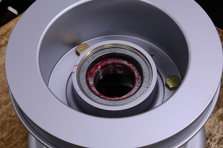

Dear Listers,
I'm just about to put the wheels on the axles. The manual indicates what kind of grease to use, but doesn't really indicate whether you're suppose to use *more* than is already gooped in the bearing when you open the Cleveland box. There seems to be a fair amount of grease already there. What's the common notion on this?
Thanks!

Matt:
I'd remove the bearings and check to be sure there is enough packed in them.
Not sure if Parker Hannifin has packed these as a presevation measure or
it's ok to use the factory grease for running on. I always use Aeroshell
#5. To be safe recommend that you clean the bearings and repack with the
recommended grease. It's not the time to install the wheels without enough
grease to assure adequate lubrication for flying.

I put mine on right out of the box. (after I cleaned things up)
All seemed fine at first condition inspection when I removed cleaned and repacked.

Matt:
   Having repacked, replaced bearings and races on my share of Cessnas, the answer is "it depends". Were the bearings packed with a bearing packer, what grease was used, and how long ago were they packed? If they came that way from Van's or another supplier, and sat in storage, you have no way of knowing, so I would wash it all out with solvent. Grease has a definite shelf life, I replace in service AeroShell packings every year and chuck the can after 24 months. Then repack them with a bearing packer ("Lisle" makes a nice one) and apply a goodly swipe to the races as well. Don't go overboard, this isn't one of those cases (like with duct tape) where a little is good, a whole lot is better, it just runs out and all over everything, when put in service. Keep the packer, you'll need it for your repacks at annual time.
