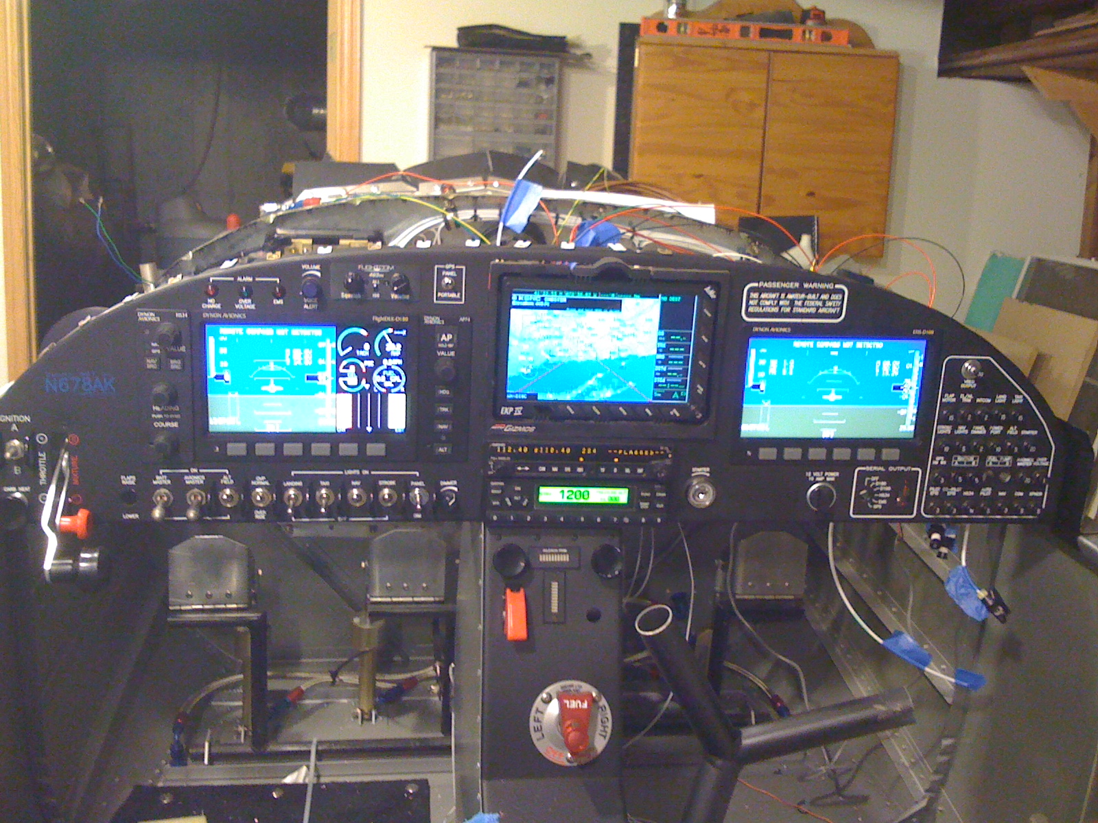

Ok Guys, while the Zenith list is rank with arguments about flutter and 601's raining from the sky, I decided to post some photos of my panel progress.
The vast majority of components are installed and about 25% of the wiring is done. As the last picture shows, I have a bit more wiring to do!

Nicely done.  How did you label your panel?

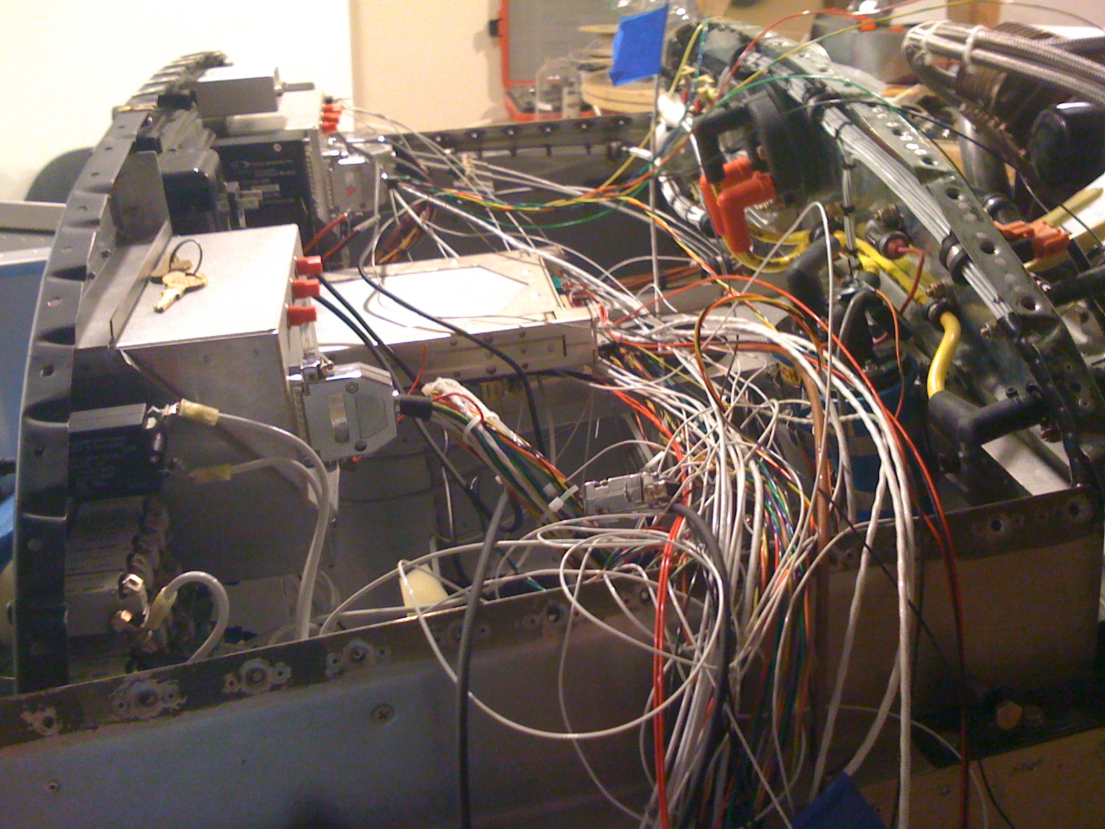

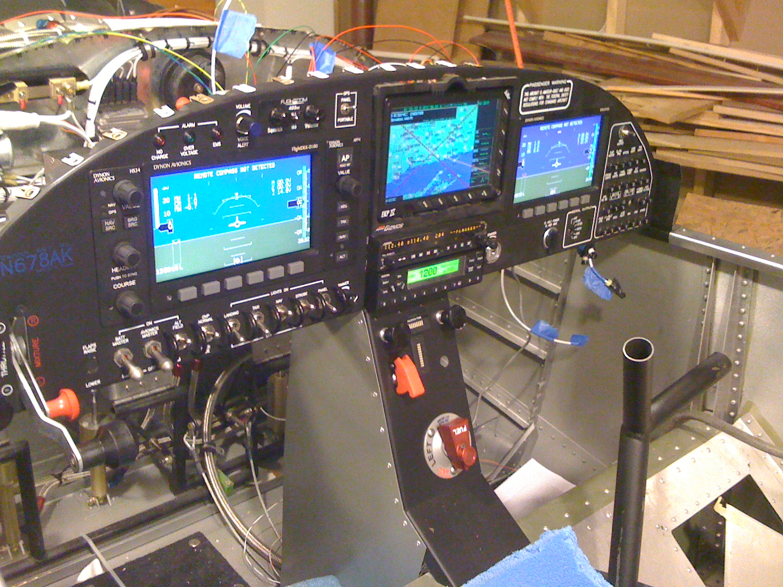

Very comprehensive. I assume the "serial output" selector switch is for
monitoring the serial output from five instruments. Is that a 9 pin DSUB
connector next to the switch? The first (CCW) position looks like it is
labeled "Off". Just a precaution so the connector can't kill one of the data
streams?
Don't you need a USB connector to update the firmware on the Dynons? Since
the clips indicate you are making your forward skin removable I suppose you
will go in that way.
-- Craig

Beautiful Ken. Keep building a little each day. I hope to meet you at a fly-in some day.

nice panel with AP74 and HS34, I guess the AP installation was an snap, right? BTW, how did you do the label? It looks great.

I too am interested on how you labeled the panel, looks like you had it professionally done?

Larry, I did the labels using a system called decalpro FX. Here is the link: http://www.pulsarprofx.com/ I highly recommend it. The system does have a steep learning curve, but the results are worth it. Also, the guy who created the system is very helpful over the phone.
Craig, you are correct, that is a 9 pin connector next to the serial switch. I made a serial cable that goes from the panel to my laptop which has a usb-serial converter. I simply connect the laptop and select which unit I want to update. I can also use it to download the ems and efis data. The main instrument is a Dynon D180 and the backup is a D100. The D100 normally boots up in to the EMS screen. The D180 boots up to a full EFIS screen. The rest of the equipment are a Dynon HS34 and AP74 and a Garmin SL30 Nav/Com and GTX327 transponder. The GPS is an Avmap EKP IV and the intercom is a flightcom 401.
Thank you all for the kind words.

Just kidding of course. Fine looking panel. I especially like the labels.
A couple of questions.
1. Where did you get the little switch guards?
2. Why the HS 34 if you have an SL30? I thought the Dynon could deal with the SL30 data without the HS34 and the AP 74 gives you the knobs and voice alerts?

One source of switch guards (two styles). Look on the right side:

Alberto, I haven't installed the autopilot servos yet. I'll let you know how that goes.
Gig, the switch guards are from http://www.periheliondesign.com They also sell a neat domino-sized overvoltage device which works good.
You are correct that the D180 will handle the Sl-30 without the HS34. There are two reasons why I purchased the HS34:
1.) More buttons and knobs! Laughing
2.) I hate assymetry, I thought the D180 looked better with the HS34 on one side and a AP74 on the other.
Just kidding, I chose to install the HS34 because I'm connecting both the SL30 and the GPS to the Dynons. The HS34 allows me to keep the D180 serial line free for updates and data streaming. Also, I needed more GP inputs for things like my trim and flap indicators. Lastly, I can change bearing sources and the obs with my left hand without letting go of the center Y-stick.

How do you find getting in and out with the throttle quadrant where it is??? Nice panel. Cheers

The quadrant is off to the side enough that it doesn't get in the way of me getting in and out.

Ken, was the $90 "starter" kit from pulsarprofx.com sufficient to do your
whole panel or did you have to order more supplies?

I used all the white film during the learning process. I ended up ordering some more white. Now that I'm more proficient with the process I could do the whole panel with just the starter pack.

Thanks! I'll be using the black on my white panel. So I think I could use
one of the other colors for practice and have all the black left for the
real panel.
Any other tips that you learned or is it just a matter of getting a feel for
it?
