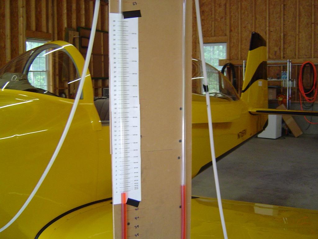

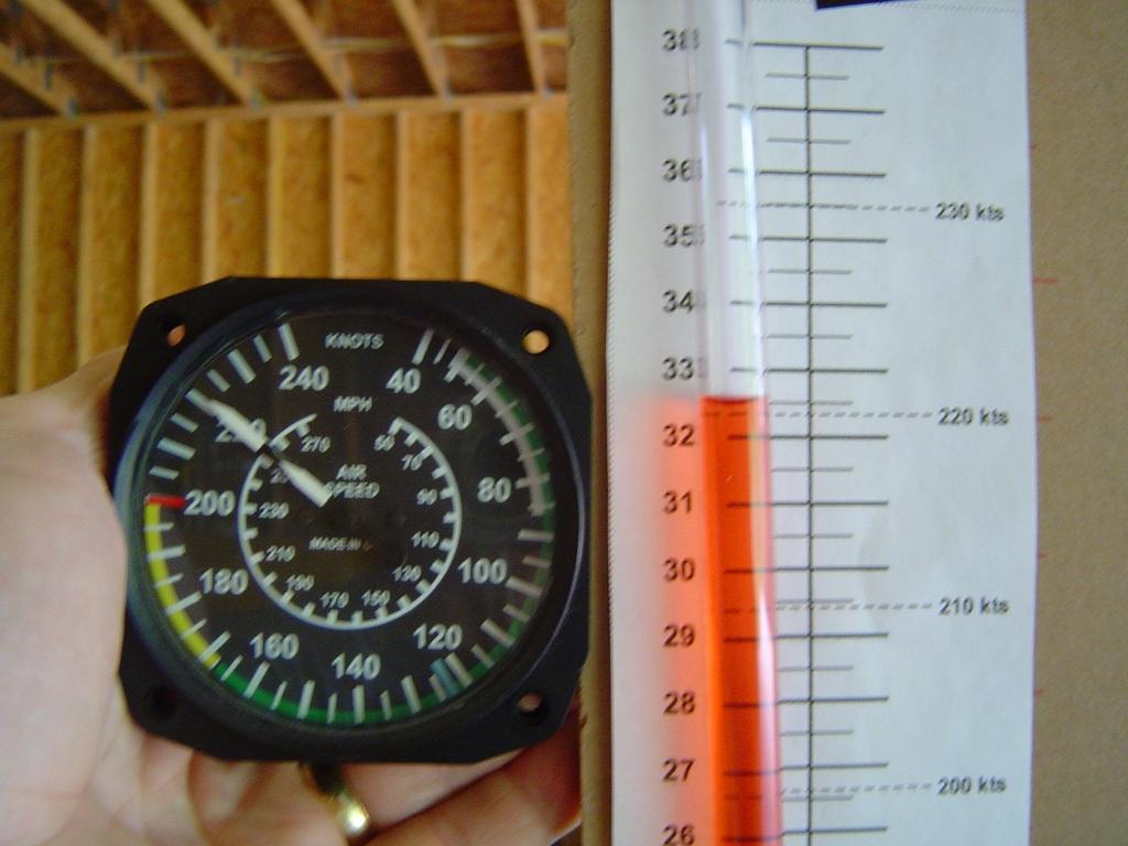

Before first flight, or anytime you have a doubt about airspeed indication,
you can do a simple but accurate check.
Photo attached on the pitot test rig I made. While the one photo is with
the airspeed indicator out of the plane, normal is to attach the tubing
directly to the pitot tube (electrical tape makes a good seal) and test the
entire system for accuracy and leaks. I used a standard blood pressure bulb
to pump up the water level - it does not take much. Also attached is the
conversion scale to put under the level tube to read out directly into
knots. As airspeed is strictly related to differential pressure, there are
no corrections for temperature, atmospheric pressure or altitude.
Carl Froehlich

I wonder if I could use different type of tubing for the manometer rig. I'd like to use the tubing supplied for the brakes. Would that change the readings?
Lenny
Bob Turner
Joined: 03 Jan 2009
Posts: 885
Location: Castro Valley, CA
PostPosted: Wed Jul 08, 2009 10:03 am    Post subject: Re: Pitot test rig (was Pitot cover) Reply with quote
Only the difference in the heights of the liquid matter, not the diameter of the tubing. And it's vertical height that matters, in case the rig itself is not vertical. The formula is: Pressure equals density (of the liquid) times the acceleration of gravity times the vertical height difference.

PostPosted: Wed Jul 08, 2009 10:08 am    Post subject: Re: Pitot test rig (was Pitot cover) Reply with quote
Thanks Bob. It helps to know how it works.
I tried it last night using the brake tubing and it worked great.
Needed it to calibrate an electronic pressure sensor.
