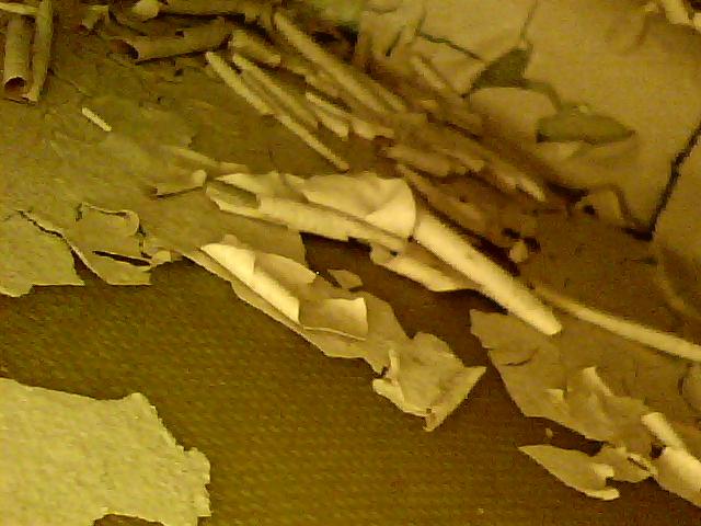

Again, thanks to everyone who responded to my orig post about the Kreem Prob, and I thought I would add some more info on what prompted me to look into the fuel tanks for a problem as well as post pics I took of the inside of the tanks with a mini webcam. I purchased the plane from the orig builder about a year ago, and started using unleaded gas either 89 or 93 oct (912ul 80hp) around Sept.(engine time around 100hrs). Within a couple of months I started having problems every once in a while when starting the engine it would run extremely rough initially, but after shutting down, turning prop by hand, it would start and run fine. I could note when it started but running rough, that I would have a cold cylinder (usually #1 or #2) . These symptoms gradually got worse until recently, after engine was shut down and cooled off (a few hours), I would have no compression at all and have to turn prop over by hand or crank with starter, then wait, then do it some more to finally start getting compression..i.e. sticking valves. Time on engine is now about 130hrs. I talked to a rotax repairman in Arlington,TN (Rodney Hardin) and he told me he had seen this happen on 912's and had found fiberglass fuel tanks being "dissolved" by the ethanol in the auto gas and the resulting contamination was causing the stuck valve problem. When looking thru the fuel tank filler opening I could see significant areas of exposed fiberglass and the flaking Kreem, so following his suggestion: I drained the fuel system and disconnected fuel lines, hooked up a temp fuel tank, and added a fuel system/valve cleaner additive, I removed the valve covers one at a time and sprayed a small amount of carb cleaner on valve stems and turned prop by hand until I got enough compression to start the engine and ground ran for about 45 minutes on Friday. On Saturday when I first turned the prop by hand I did not have the normal full compression(like I feel when shutting down engine) , but enough to start engine and it ran normally (no roughness) and so I ground ran for another 20 minutes. On Sunday I turned prop over by hand and it had what I believe to be "full compression" on all cylinders like it used to before this scenario started. Mr Hardin said he had seen fiberglass tanks (not kitfox ones) that were deteriorated so bad they were not structurally sound and attributed this to the ethanol in the gas. At this point I can only say that I believe something in the unleaded gas reacted with either the fiberglass resin, or the Kreem, or the mil-h-6000 fuel hose and caused the sticking valve problem. My plan now is to remove wings and use MEK to remove the Kreem and then re-slosh with Kreem per several replies to my original post. I am also going to change the fuel lines to one of the types recommended on this or the rotax forum. Sorry for the length of this post, but maybe someone else may benefit from my experience.
Thanks again, Paul Perry KFIV 912ul
Inside rt fuel tank showing the flaking of the Kreem the exposed fiberglass area is probably about 6"x8" just in this one spot

WOW, that picture is unbelievable.
If Kreem is done right the ethanol can't hurt it. This was either done very wrong or it is not really Kreem.

I'm assuming that the Kreem was coming off for sometime probably due to the inadequate cleaning of the release agent from the mold process by the manufacturer (Skystar?) as stated on this forum by several others. Sorry, I'm not familiar with what's available in Canada, but it can be purchased from JC Whitney online, and you might check with motorcycle parts suppliers. Paul P.

Looking at those tanks, I don't think the Kreem coating was done right from the start. Ethanol doesn't effect Kreem like that unless it was done wrong and got up under the coating and loosened it. Something was definitely wrong.

I agree.....I used Kreem in my never-before-used fuel tanks, and
haven't had a bit of problem in over three years of use. The trick is
to follow the instructions...this is NOT an area in which to
*experiment*. Of course, I fly an airplane, and use airplane fuel,
not fuel meant for an automobile.
