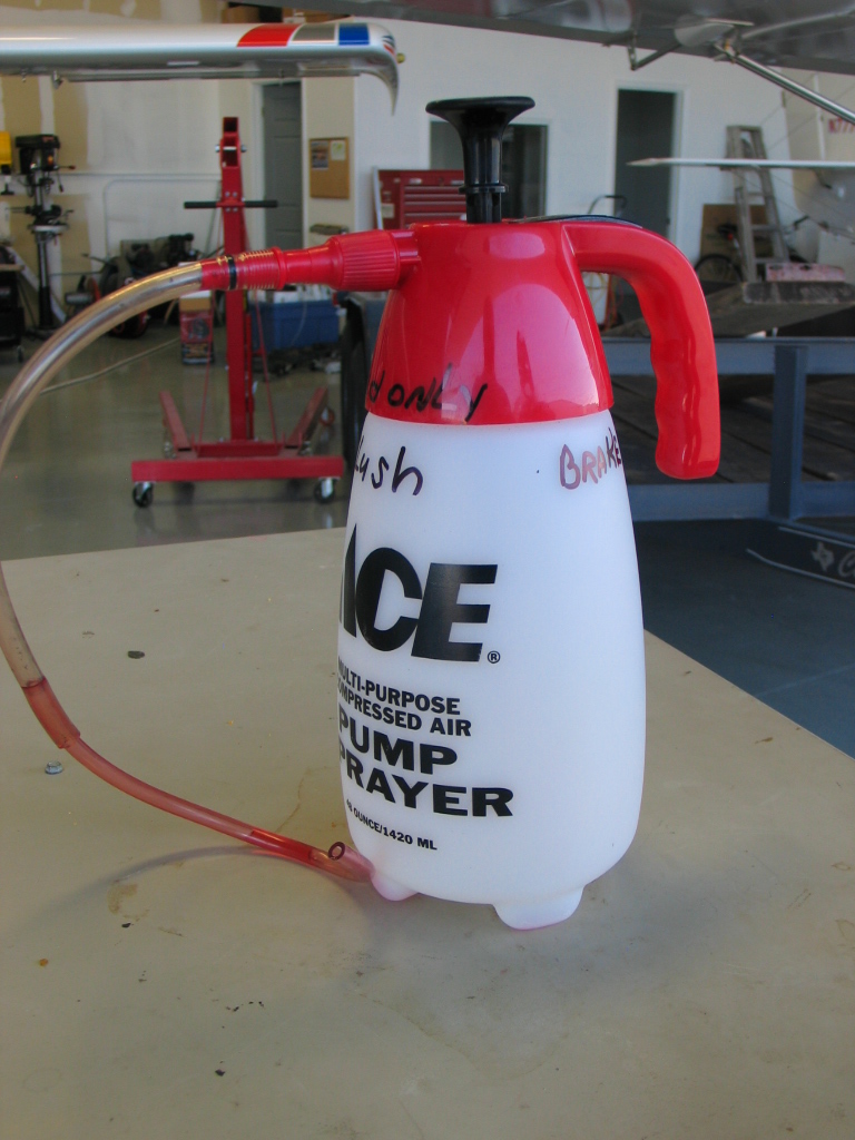

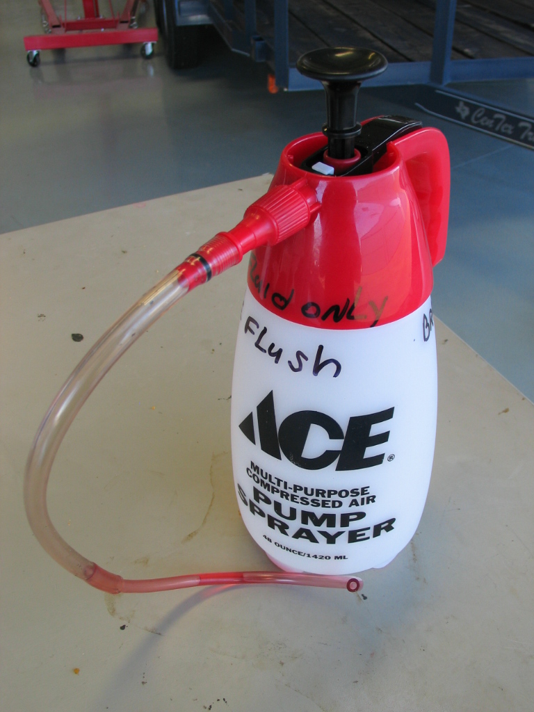

PostPosted: Thu Aug 06, 2009 5:30 am    Post subject: Re: Brake lines filling Reply with quote
Here is what I use. From Ace Hardware for about $10. It is a small bug pressure sprayer. You pour the brake fluid in and pump it up. I used to use an oil can, but this is so much faster and easier. You slip the plastic tube over the nipple, loosen the nipple and pressure the lever. Air pressure forces it at a fast rate through the system for filling and takes all bubbles with it. I put a plastic water bottle on the other end with another tube at the reservoir to catch the over flow from the flush. Piece of cake.
