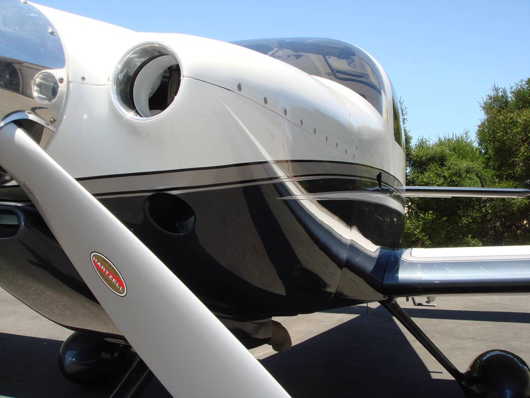

Forget piano hinges and wires, they are a pain in the butt.
I used SS camlock fasteners and adjustable receptacles from SKYBOLT FASTENER from Apopka Florida. They are easy to install,, and fit tighter , also removal and attaching the cowl is quick, easy and positive. I now have over 3000 hours on my RV8 and the cowl fits just as good as when it was installed. Good luck.
Dick Martin

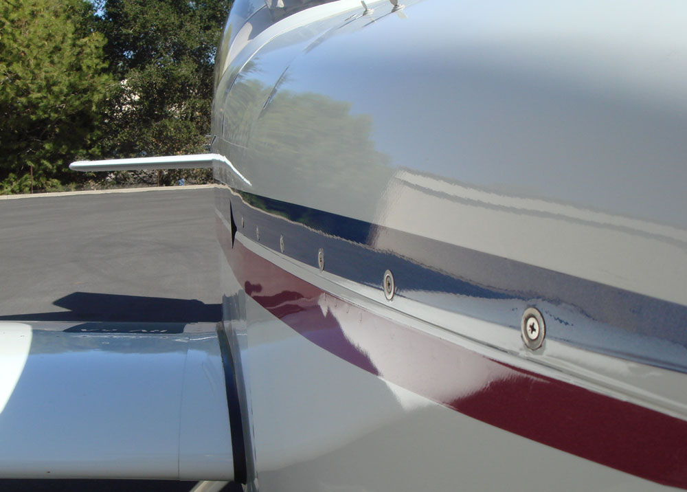

I strongly concur with Dick. I use the Skybolt fasteners on my RV-10 cowl and they work great. Plus they give that big iron look to your build. There is a downside in that they are expensive and heavy. II think my -10 ran close to $400. individually they don’t seem too heavy but when the box arrives and you are holing all the parts they do add heft.
As an alternative on two of my RV’s instead of the cam lock style we used #8 SS screws and tinnerman washers. The look is similar but the cost is nominal (few cents a screw/washer) the upside is they can be replaced just about anywhere. I love the Skybolt system but plan to use the #8 SS screws and tinnerman washers on my “budget” 8A coming next.
Robin
Skybolts:

Here's another vote for screws and nutplates for the top and bottom of the cowl/firewall join. I used #6's on my RV-6 and have been very pleased for the last 8+ years. I used the stock hinges on the sides of the cowl/firewall join and on the mating line for the top and bottom cowl.
Given my experience, I'd do it the same way if I was a repeat offender.
