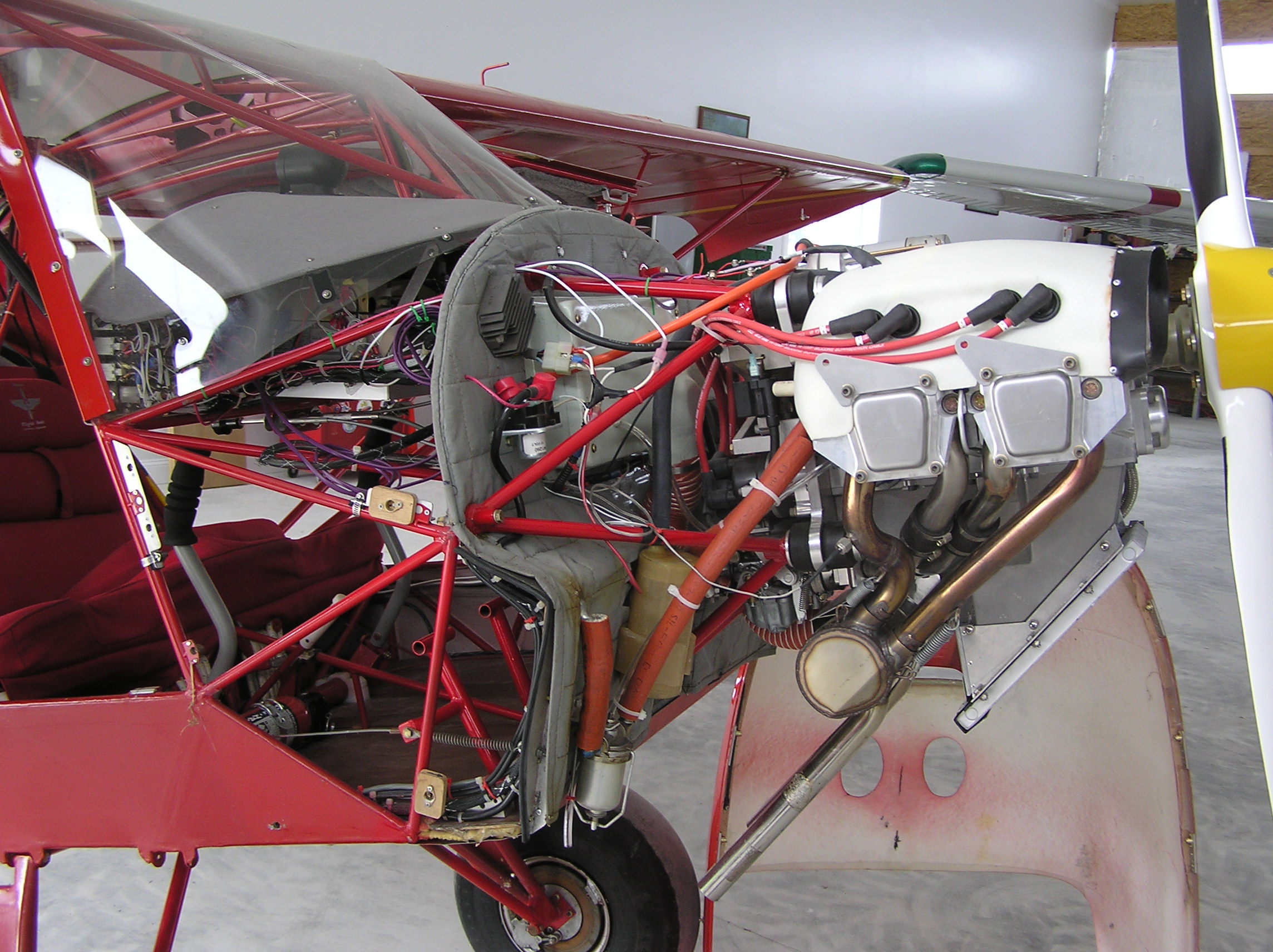

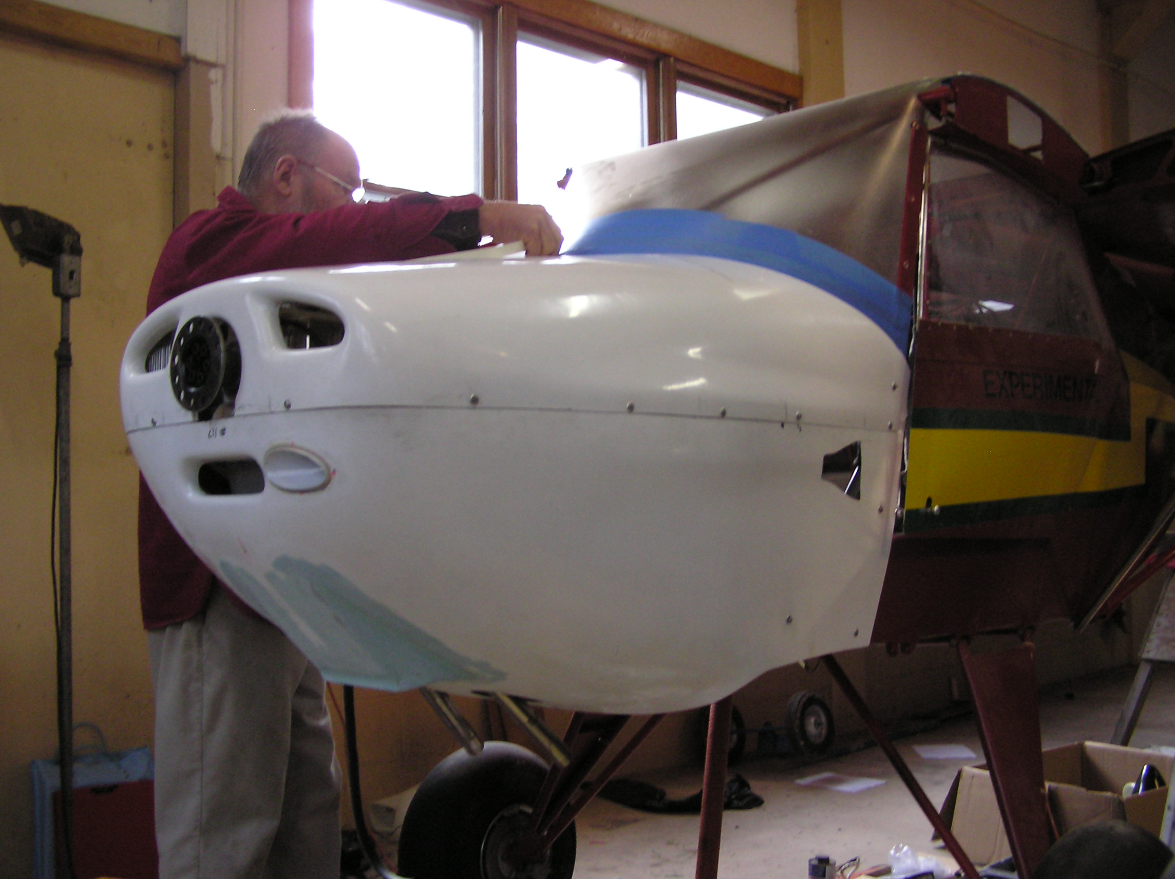

ronal22(at)verizon.net
PostPosted: Tue Aug 11, 2009 7:19 am    Post subject: Engine Options Reply with quote
My oil cooler is located right in front of cooling fins on the Jabiru 2200 oil pan or case. There is about 0.5 inch clearance between the two. I have a bump-out over the cooler on the cowling with an opening at the bottom of the bump-out. This is so the air coming in the opening on the bottom cowl can flow over the oil cooler/engine case and then exit without pressurizing the bottom of the engine compartment.
When I got my cowling, John McBean was not in business. If he has the smooth cowl for the Kitfox IV, I would certainly look at that. My dealings with John have been excellent.
Ron Smith, Kitfox IV
Jabiru 2200, S/N 2030, 150 hrs.
Lewes, DE
