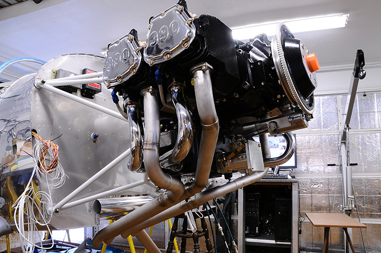

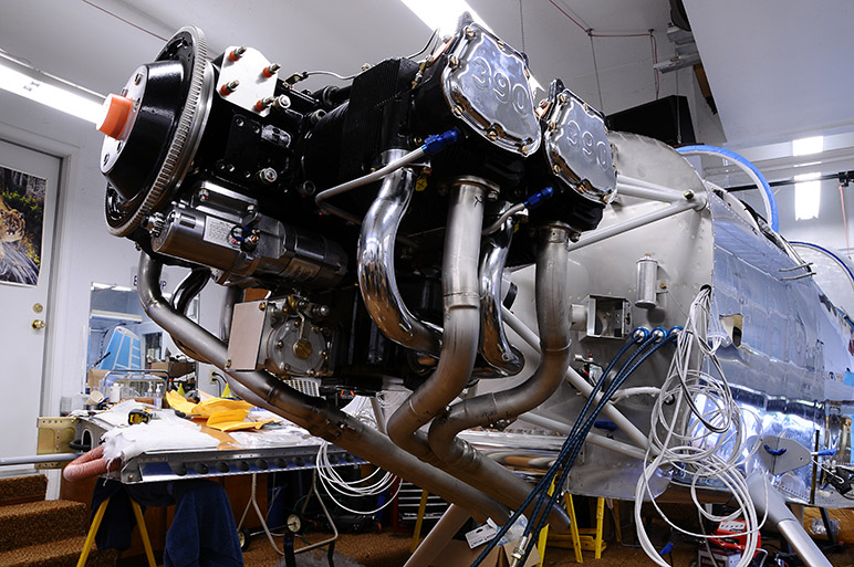

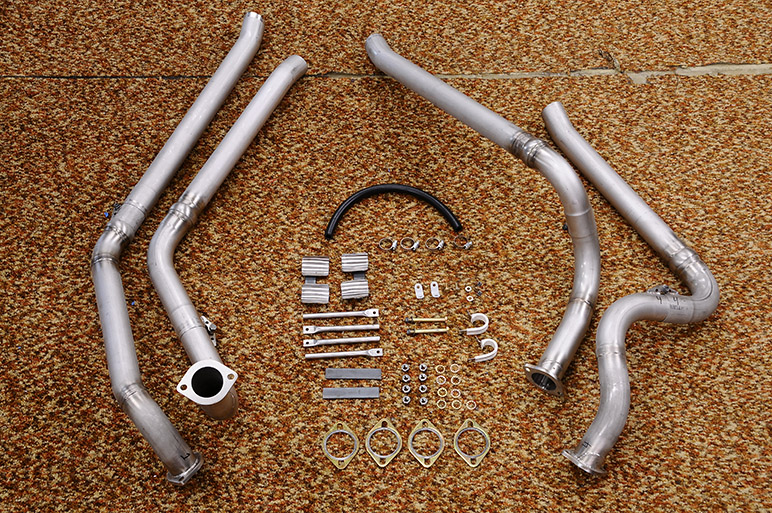

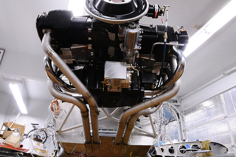

I got the Vetterman 4-into-4 RV-8/IO-390 exhaust system installed last weekend. It fit perfectly, and looks awesome too! I've attached a few pictures on the installation. (Digest Listers: Check the Forums interface for the pictures at http://forums.matronics.com/viewforum.php?f=4 )

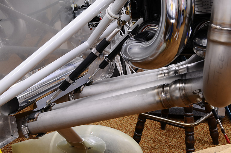

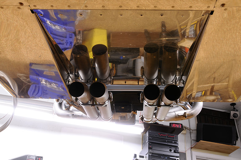

Here's my question. How close should the pipes actually be to the bottom of the exhaust ramp? The mounting system will allow me to push them up pretty close, but is that wise? The installation instructions didn't really lend any guidance here.
BTW, the IO-390 engine went on without a problem. Here's some pictures:

The closer the exhaust pipes are to the exit ramp the more the exhaust pulses will affect the floor. This increases the risk of cracking the skin and failing the rivets in the area. Some builders use the "turned down" extensions to mitigate this. Not sure if the benefits have other effects, though.
              John D RV8
