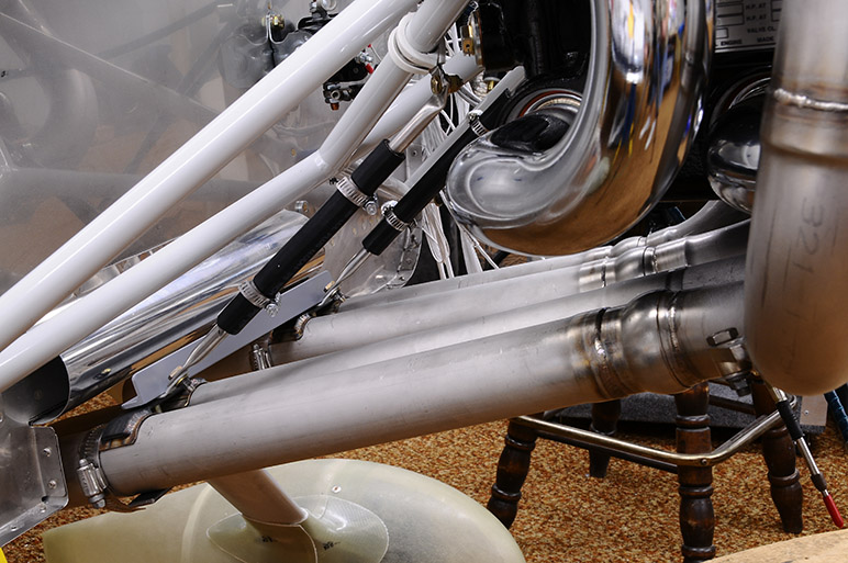

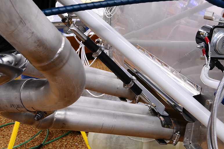

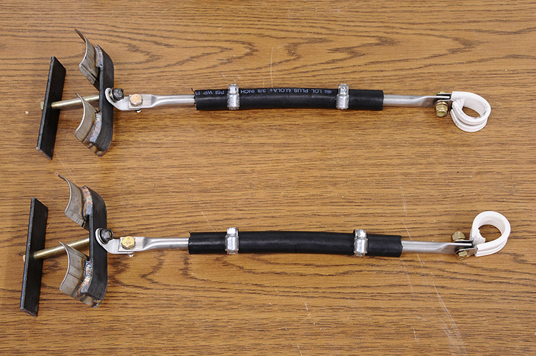

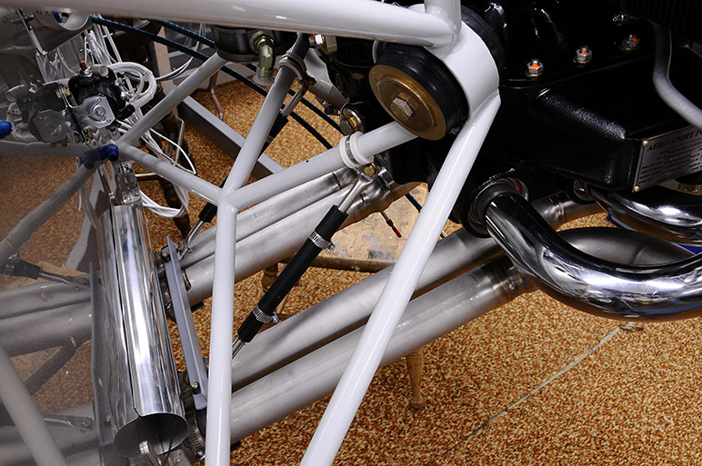

I have the 4-into-4 Vetterman exhaust on my RV-8. The instructions stated to mount the hangers to the engine mount. Here are some pictures of my installation. There might be more options on the RV-7, don't know.

Thanks Matt. Beautiful installation. The mount on the 7 is quite a bit different than the 8 by the looks of things but the concept of the hangars is the same. I'm going to give Larry a call today to see what he recommends. I'm probably just missing something but I'm also concerned that the hangar is going to interfer with the location of the scat tube for the heat muff. I didn't see where you had your heat muff installed yet. On my setup, the instructions say to put it over tubes 1&3 (it's a double heat muff) as far aft next to the hangar bracket as you can. Since it's a double muff, you can't rotate it on the pipe, and the heat outlet would be right under one of the hangar rods. I'm sure Larry has an answer - I can't be the first.
Thanks again.
