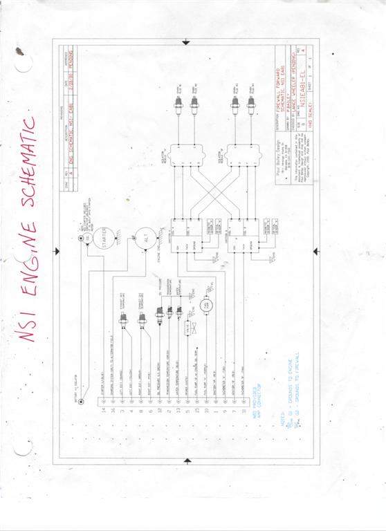

Assuming you have the stock NSI package with no modifications, it sounds
like you have the isolation modules miswired. Do you have the schematic for
it? If you don't, let me know and I'll see if I can find mine and get a
copy off to you.

It is a stock NSI ignition...A schematic would be great!

PostPosted: Mon Sep 14, 2009 1:27 pm    Post subject: Hi everyone, I'm back with a -4 with NSI questions.. Reply with quote
Howard, I scanned the schematic for you and attached. Let me know if you
can read it OK. If not, I can snail mail you a copy of it.

I'd really appreciate it if you could mail me a copy...I can't read the text on the scanned image.

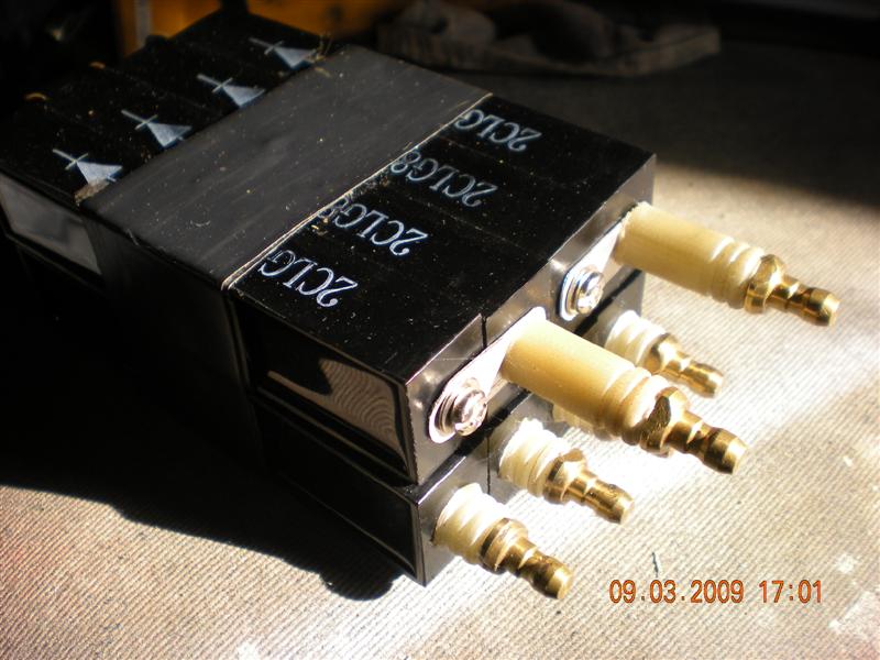

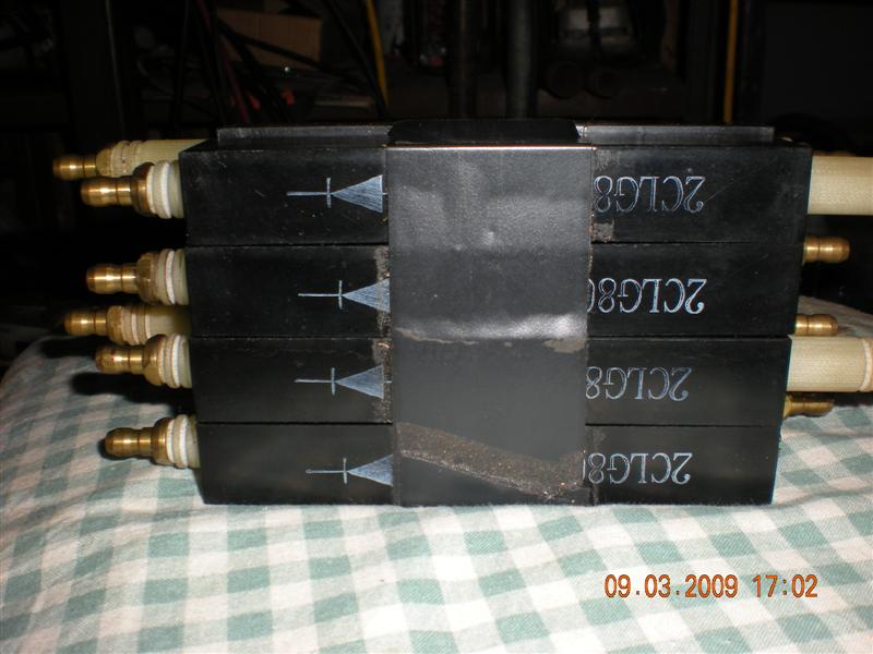

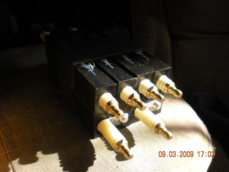

PostPosted: Mon Sep 21, 2009 5:20 pm    Post subject: Hi everyone, I'm back with a -4 with NSI questions.. Reply with quote
Hi, Mike, Jim, Howard, and interested others. After having two of these
modules go bad from leaking diodes (the diodes don't go bad, just the
potting compound gets cooked which causes the diodes to leak to each other)
I decided that it was just a bad design
and no amount of trying to redo it would make them reliable for the long
run. Sure, some of them go 300 plus hours, some less, and some more, but
they all seem to go eventually and it's not like one can buy one off the
shelf.
I got to poking around on the net and I found some 80kv diodes with threaded
female terminals at each end. I was able to use the terminals from my
existing defective modules to fabricate a block of diodes that is roughly
the same size and weight as the NSI units. A little lathe work to turn down
and rethread the male terminals to the correct size to match the diodes and
everything went together nicely. Rather than having 48 of those little
microwave diodes crammed into the small space that the modules allow I now
have only 8 of them and no housing is needed.
Now, for the rest of the story. drum roll please...
I haven't tried them yet as I've been too busy flying to take the airplane
down as it will require new spark plug wires and some configuring before I'm
satisfied. That can wait until this winter when I'm snowed in and I take
the airplane down for annual. One thing I need to figure out is the
polarity on those GM coils on the ignition modules. The two high tension
coil terminals have opposite polarities. Anybody know which side is which
or a way of testing to find out?
I've attached photos for those who are interested. Scroll down.
Deke Morisse
Mikado Michigan
