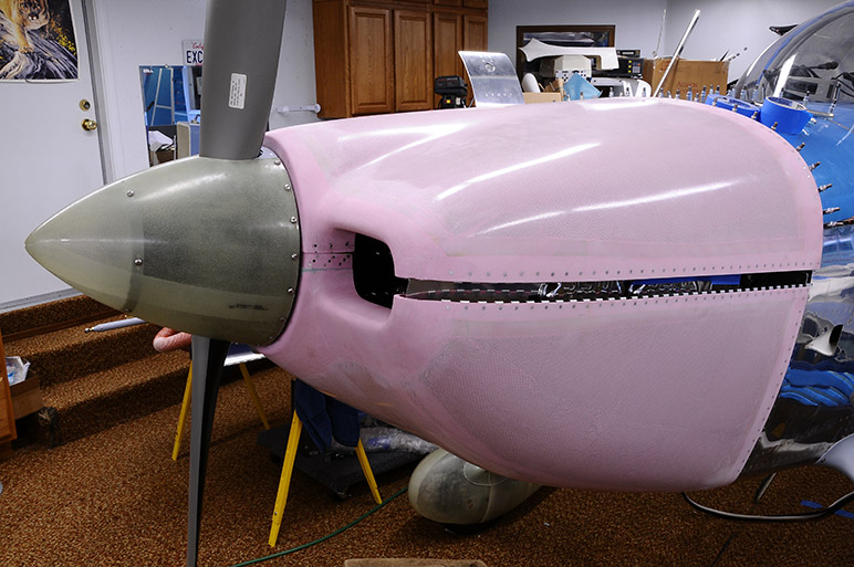

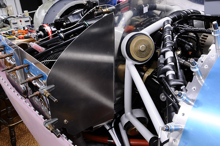

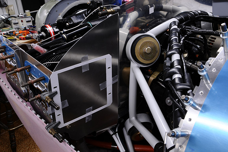

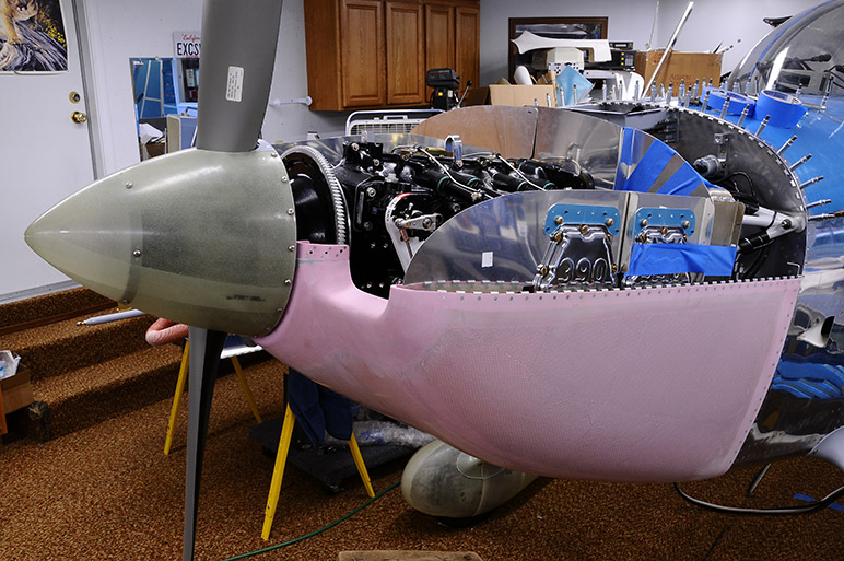

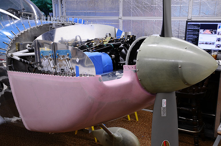

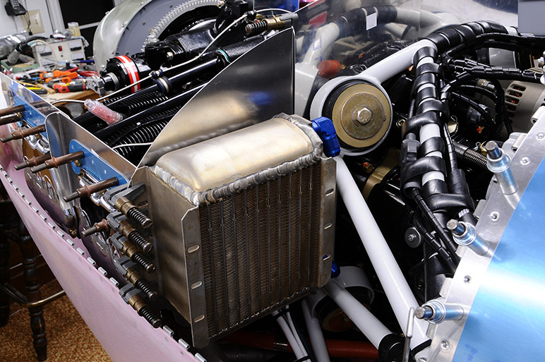

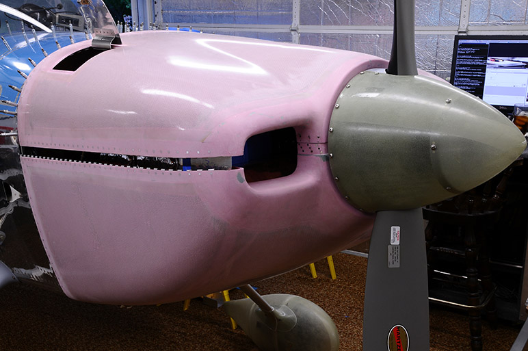

Dear Listers,
The RV-8's cowling done and fits like a glove. I started the baffling last night and its coming along nicely. The fit on the sides and back are very good considering the IO-390 installation (and the use of the IO-360 baffle kit). The front baffling is completely different, however, and I'm slogging through the custom fitting.
But here's my question. I decided to put the top cowling on top of the baffling that I've got installed so far and I was shocked that the baffling appears to be a good 1 to 1.5" too tall!! Is this because of the IO-390 or is that just where Van's expects you to start in your "cutting-it-down-to-size" phase? That's a lot of snipping and fitting and snipping and fitting. I was expecting to have to trim some, but not over a inch...
Also, it looks like the over-sized oil cooler is going to fit nicely on the rear baffle with only a little "modification". But I'm not sure if the back, upper corner is going to clear the cowling. Since the cowling is sitting over a inch high right now, I've got no way to really trial fit the oil cooler and check for cowling clearance until I trim the baffling down. Worst-case I could put a blister on the cowling for the rear, upper flange of the oil cooler, I suppose, but that's kind of hokey. There is room to move the oil cooler in towards the centerline about 1", but then the mount will no longer line up with the flange on the outboard edge and will require more modifications.
Thoughts...?

It's pretty in pink!
Sorry, I could not resist!

PostPosted: Tue Sep 15, 2009 3:53 am    Post subject: Initial Baffle-To-Top-Cowling Fit... Reply with quote
Yep, cut away... On my RV-4 and RV-10 you cut quite a bit of the
baffling away. In fact on the -10. There is only like 3/8" of
baffling left above the #1 and #2 cylinders when complete. Make sure
you have the air inlet scoops installed in the upper cowl too, or
there will be more cutting later.

I just wanted to thank everyone for the great feedback on this baffling cut-down procedure. I'm glad to hear that it wasn't just my installation!! Smile
I'll post some more pictures when I get things hacked down to size and that oil cooler mounted.

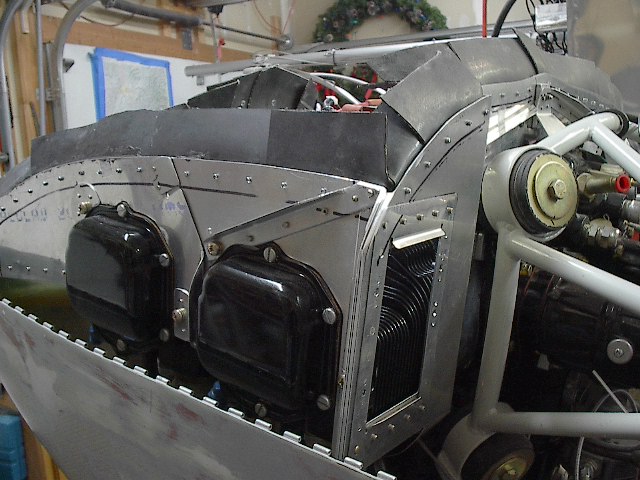

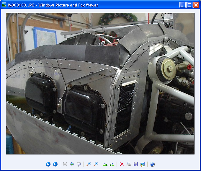

PostPosted: Fri Sep 18, 2009 10:47 pm    Post subject: Initial Baffle-To-Top-Cowling Fit... Reply with quote
RV-8 O-360 rear baffle mounted van’s oil cooler.
Frankly, I found the baffles to be a time consuming nightmare.
So far temps fine, Oil temp fine.
RV-8 N8432 16hrs.
Vince H. (Idaho/Washington)
