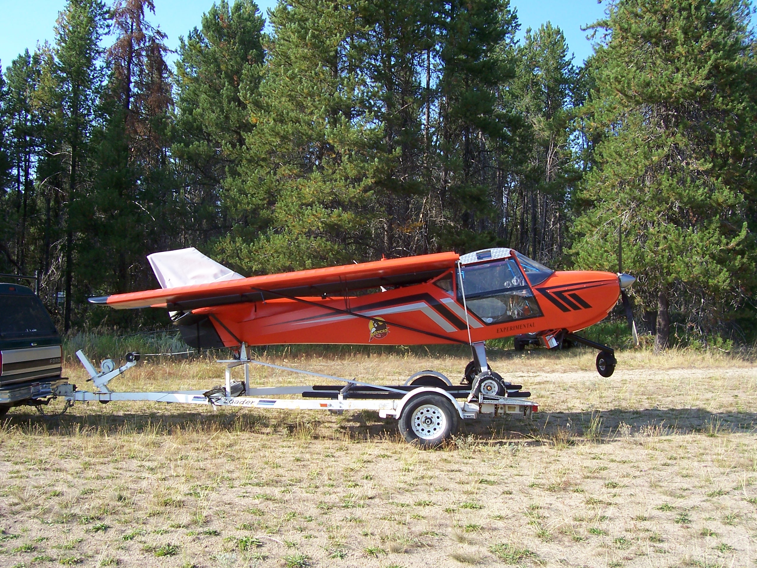

I have a boat trailer that I have adapted for my Kitfox. I haven't seen a Vixen being trailered, so this may be different from yours. I have included a picture. Supports are always used, either homemade or purchased from John McBean. Hope this helps.
Ted
 Filesize:  1.95 MB
 Viewed:  9191 Time(s)
Ted (Earnest Jacques)

PostPosted: Sat Sep 19, 2009 7:25 am    Post subject: Long distance trailering Reply with quote
That sounds great.  How about some pictures C Thanks for sharing.
Thanks for that. It's a beautiful machine. Good job!
