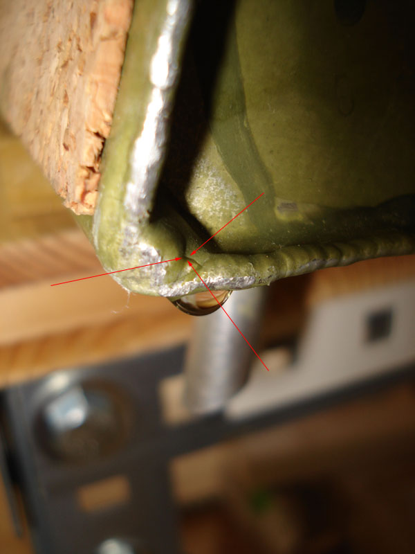

I had a leak in one of my brand-new fuel tanks (see picture attached). As Klaus said, I would also remove the wing to further investigate the problem.
Cheers Martin

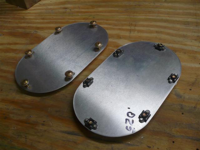

Bob Mahieu called me and asked about the access holes. I called Zenith and Roger told me the hole goes between ribs 2 & 3. Bob and I made holes 70mm by 140mm and have clear view and access opened.
I made the cover plates tonight and will be out there either tomorrow or Thursday before the meeting to install them.
Fuel line tank access covers
