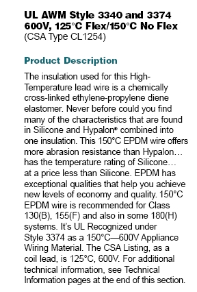

The Anchor brand welding cable illustrated above
has an HDPM outer jacket which is revered for
its flexibility and toughness. Here's an excerpt
from a wire catalog describing this insulation.
[img]cid:.0[/img]

I looked at some wire in the junk box that
I think came from an installation kit for
an automotive super-sound system. The insulation
was decidedly plastic looking (shiny) and
also had a paper liner.
Hey, good find on the web-source! Looks like
their prices are really good too. As you can
see from their offerings, there are MANY different
kinds of insulation . . . EPDM is not the magic
material, just one of many that would be
suitable. I didn't intend that one zero in
on EDPM in that manner. The fact that a reel
of wire (or a catalog page) cites EDPM says
that you KNOW what's being offered. That reel
of shiny stuff with unknown and/or questionable
insulation material MIGHT be okay. Without
identification or other qualification data
like materials or temperature ratings, it's
good to move on and consider other sources.
Looks like the WesBell folks are an excellent
source of wire suitable for use as fat wires
in your airplane.
