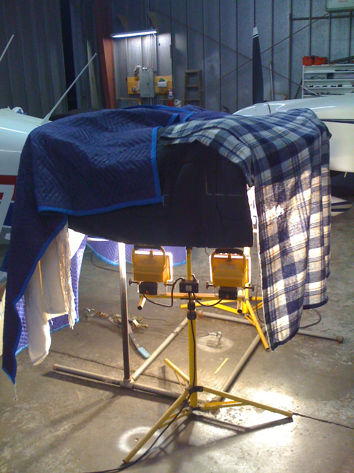

If this attachment comes through, you'll see the tent I made for keeping the aft area warm. I added some blankets since this pic. Yesterday, the temp stayed between 120 and 125.

The temp yesterday was 150 degrees. I was going to wait the full 7 days, but, I've been able to keep the temp above 120 degrees since installation and over 150 for the last 2 days. If I extrapolate the data Hysol has, it isn't linear. So, the best curve fit I can get shows that I need 120 degrees for 5 days.
