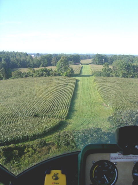

PostPosted: Fri Oct 23, 2009 8:41 am    Post subject: Any Kolb instructors close to Burlington Iowa? Reply with quote
1200' is plenty, especially if there are holes at the ends.
The sumac on this end is tall enough to keep me steep so's not to scare the folks on I-90
BB MkIII, 28' wings
[img]cid:DBEECF18-4F69-4ABD-A621-FDDFFF346C07(at)frontiernet.net[/img]
