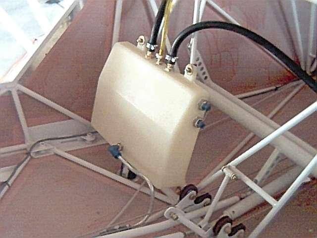

I plan on using a collector tank, behind the seats in my 701. The 750 has less behind the seat and not in the cabin room then the 701 but surly there is room for 1 gallon or so someplace. The attached pic is from a kitfox.
Kevin

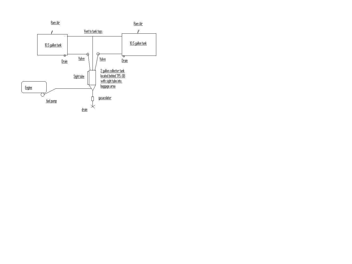

i was planning the same kevin but i have a question where do u plan to run the vent line?
dave

This is what I plan on doing. I may use a level switch for the "oh shit"
level in the collector in stead of the sight tube?
Kevin
