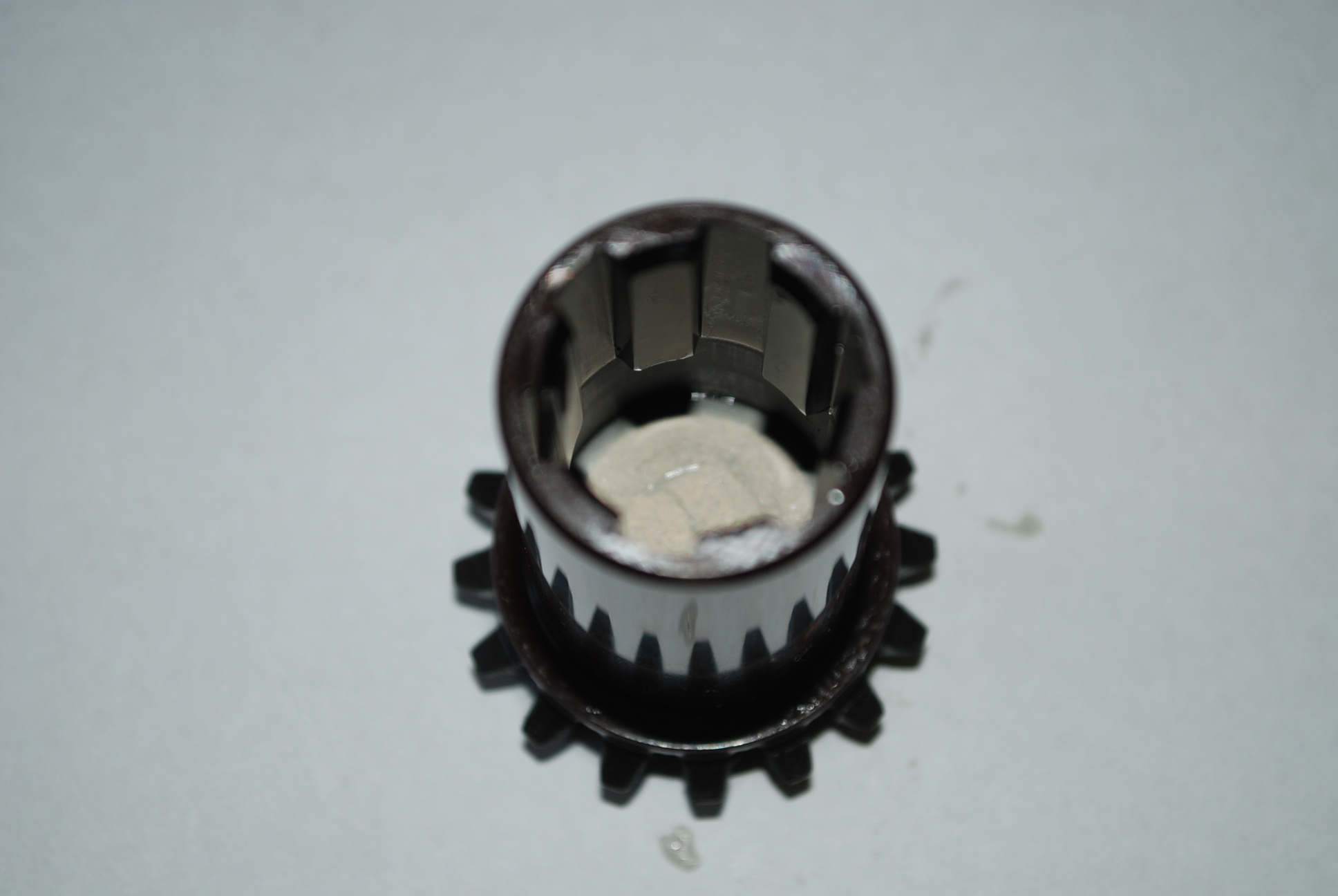

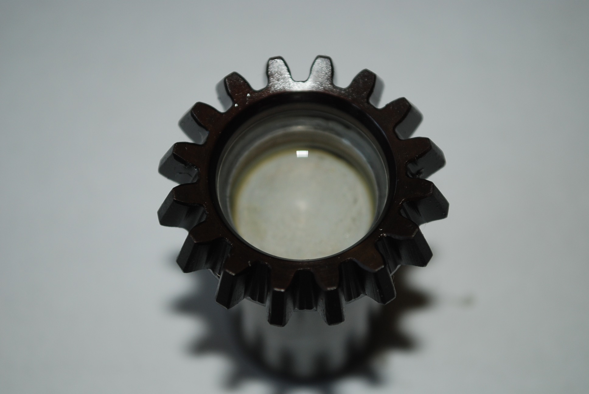

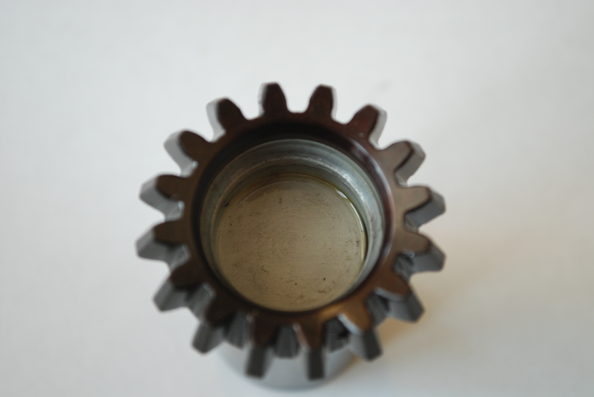

PostPosted: Sat Nov 07, 2009 5:20 am    Post subject: Re: B&C alternator conversion on a stock CJ. Reply with quote
The design of the Housai and M-14P generators are different in how the lower bearing on the generator is oiled. Hence, the pinion drive gear is different.
I have attached three pictures of the M-14P pinion drive gear here. Note the gear has a metal plug at the base. The Housai gear does not.
In the B&C application, this metal plug serves two purposes:
1) it keeps oil out of the bottom of the alternator during aerobatics (a very good thing), and;
2) it provides support to the male shaft that fits into the female splined part of the pinion gear. Without this support, the male shaft, due to gravity, vibration, etc will fall out of the shear coupling that is on the alternator. When this happens, the alternator stops spinning (now you are flying off battery power only). This can also cause the shear coupling in the B&C design to fail. (the shear coupling is replaceable and is there to protect the engine in the rare case of a bearing in the alternator seizing).
Bill (owner of B&C) was considering making an injection moulded male shaft with a collar on it that would prevent the shaft from falling out of the shear coupling. This only solves item 2. However, he did have one customer who had a hole worn thru the metal plug after many hours of flying. So, the injection moulded part was to prevent this from happening. What is unknown is what the wear on the collar may/will be.
I hope this helps.
Craig
