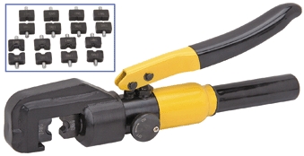

Not as inexpensive as the $10 pound-on-it crimper, but...
These occasionally go on sale at HF for under $50, and with a 20% off coupon on top of that, for <$40 a very nice tool that crimps from AWG-12 to 00 cables.
http://www.harborfreight.com/cpi/ctaf/displayitem.taf?Itemnumber=66150
[img]cid:7.1.0.9.2.20091109083511.149f8348(at)gmail.com.0[/img]

PostPosted: Mon Nov 09, 2009 10:43 am    Post subject: Re: Was wire size, now crimping heavy wires Reply with quote
If you go to Ebay and enter "hammer crimper" there are a bunch of them for little money. I have a hammer crimper and it works like a charm.

PostPosted: Mon Nov 09, 2009 3:15 pm    Post subject: Was wire size, now crimping heavy wires Reply with quote
I have one of these. It works great for crimping some large wire gauges - 8 tons of force, hex crimp, etc. However, the dies that are supplied with it are completely marked incorrectly - at least for the type of terminals we typically use in aviation. The range is on the small size in reality and most of the dies are not usable.
It will, however, crimp standard #4, #6 and #8AWG wire terminals using the dies marked "00" (biggest), "0", and "2" respectfully. It might do #10, but I didn't have any around to try.
So, it's cheap..and it works...just don't expect a correct die set.

PostPosted: Mon Nov 09, 2009 4:01 pm    Post subject: Was wire size, now crimping heavy wires Reply with quote
And here I just thought they were marked in metric units <grin>
A bit of labor with a die grinder does wonders.
I don't recall exactly where I got dimensions from, perhaps AMP, but they can be made to work quite well.

PostPosted: Tue Nov 10, 2009 7:37 am    Post subject: Was wire size, now crimping heavy wires Reply with quote
Good ole’ Harbor Freight. What would we do without that 500 billion dollar trade deficit. I bought a pair from Stein (also imported) which doesn’t require a shaving kit full of dies, but does cost a few extra bucks. Convenience worth the money. See their tools page.
