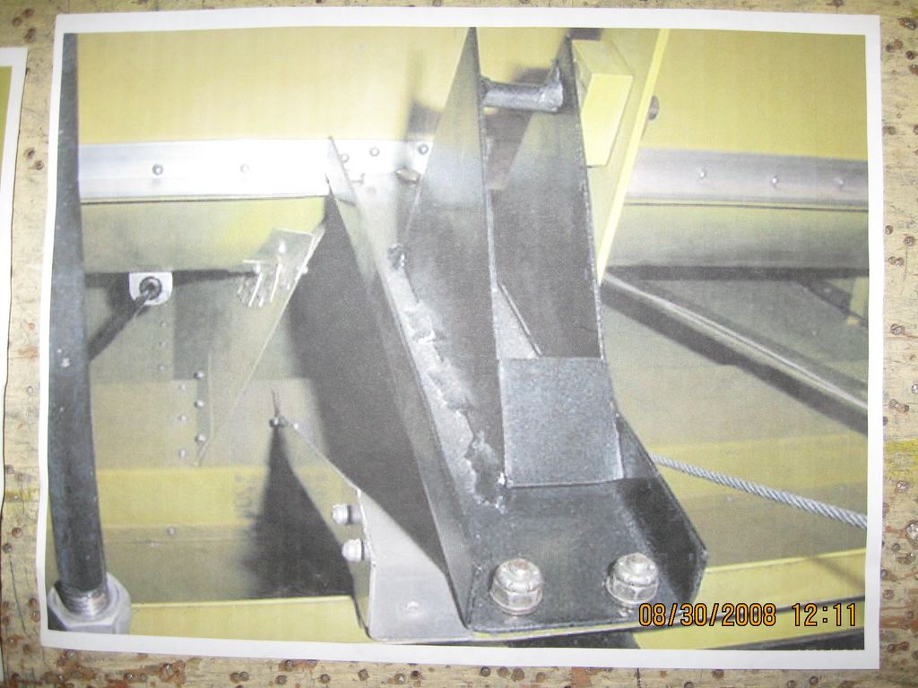

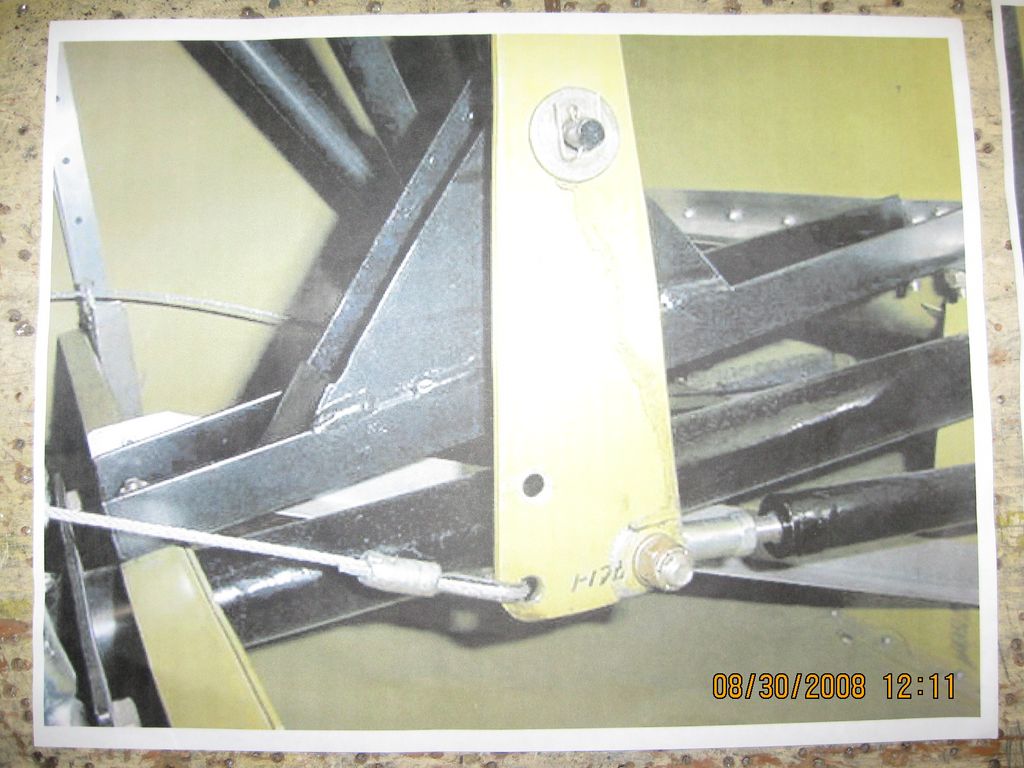

Geoff
Here are a few pics of the mod, that makes everything work properly. Sorry for the poor quality of the photos.
Robert

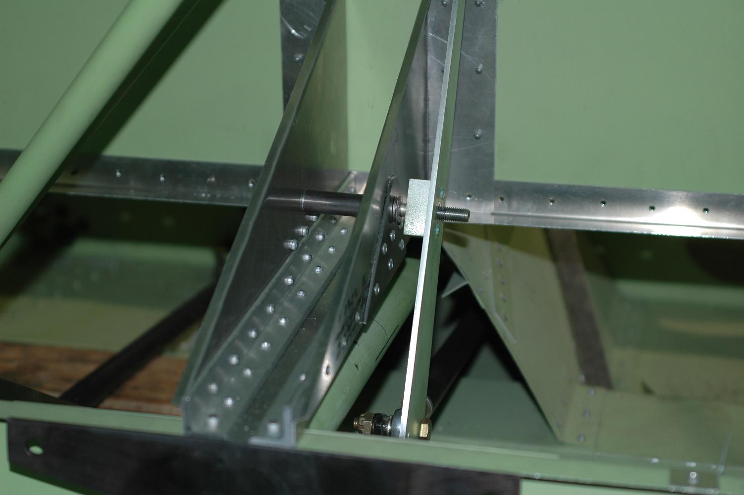

PostPosted: Tue Nov 17, 2009 12:46 pm    Post subject: Re: Elevator Cables Again Reply with quote
Sorry I couldn't get back until now. I see all questions answered. Roberts pictures are the ones I was trying unsuccessfully to find. Attached is a pic of my aileron bell crank removed from the torque tube and re mounted on a base ready to re assemble.....Geoff

PostPosted: Wed Nov 18, 2009 8:29 am    Post subject: Re: Elevator Cables Again Reply with quote
David. If by CW you mean those universal swiveling ball ends then the answer is yes. I don't think they are necessary with this Mod but the action will be smoother than making connections with bolt, castle nut and
cotter pin....Geoff

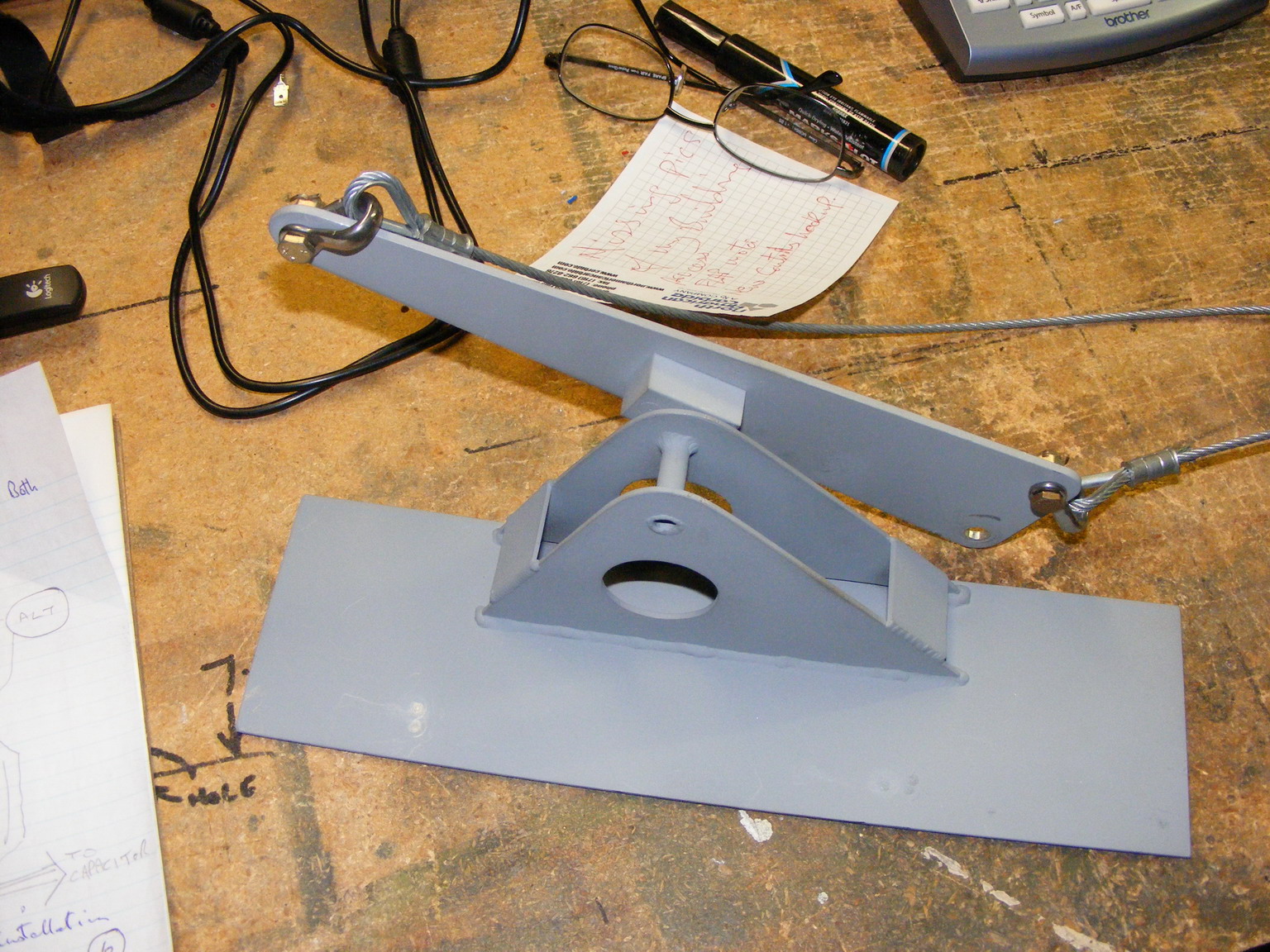

PostPosted: Wed Nov 09, 2011 11:32 pm    Post subject: Re: Elevator Cables Again Reply with quote
My version of the divorced elevator bell-crank mount
dave
 Filesize:  121.45 KB
 Viewed:  43684 Time(s)
rockiedog2
Joined: 03 Mar 2010
Posts: 19
PostPosted: Thu Nov 10, 2011 3:11 am    Post subject: Elevator Cables Again Reply with quote
Well that sure oughta hold up.
