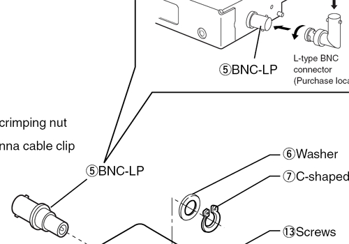

I can't imagine that this style of connection is any part of
an Icom product. The male end of this adapter is an RCA Audio
connector not often used at RF by anyone. My copy of the Icom
install manual has this image:
[img]cid:7.1.0.9.0.20091130140030.01e5c230(at)aeroelectric.com.1[/img]
Icom appears to have acquired a STRAIGHT version of the TED
connector with a BNC female termination on it. This would
nicely accommodate both aircraft and ground/portable ops
with any combination of BNC adapters and rubber-duck antennas.
The Icom supplied connector is not one I've seen before. TED
may even have built the thing. The TED connector I suggested
will, I believe, replace the BNC adapter described above
and allow you to attach the feedline coax directly
to the tray connector. Alternatively you can install a short
pigtail of RG400 on the tray connector with a cable female
on the other end so that you're transition to the world
of BNC connectors is preserved.

Are you talking about THIS guy?
[img]cid:7.1.0.9.0.20091130183948.01d59b78(at)aeroelectric.com.2[/img]
[img]cid:7.1.0.9.0.20091130183948.01d59b78(at)aeroelectric.com.3[/img]
