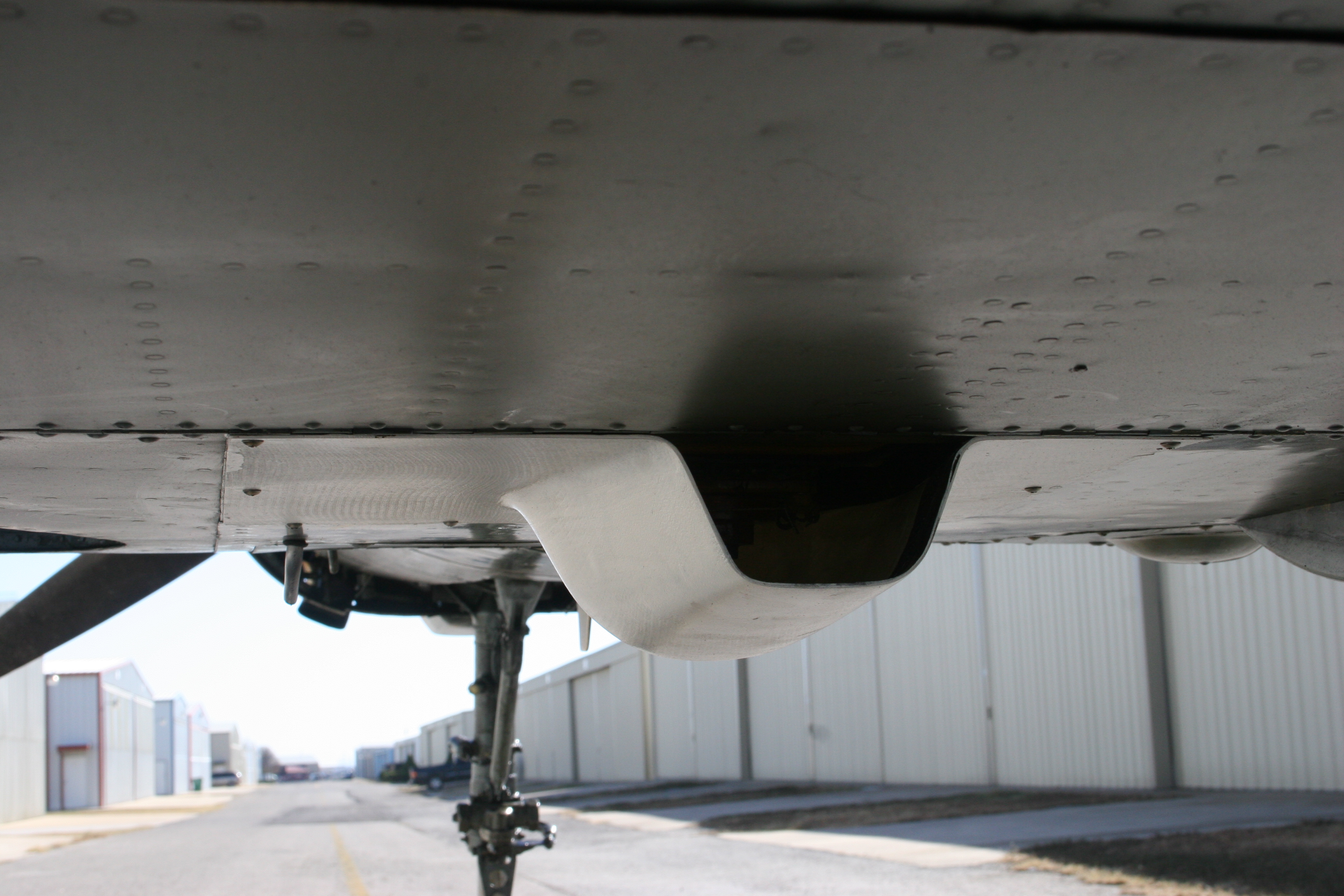

I had a reverse scoop made for the panel on the center fuel tank. Made big difference but made the cockpit colder. Low pressure behind the scoop suck air out big time. Had it off and on several times and you can tell a difference
On Dec 10, 2009, at 3:28 PM, Hal Morley wrote:
On my old CJ I added 5" extensions onto the stacks and that reduced the smell of exhaust in the cockpit quite a bit. If I had kept the airplane I would have modified the stacks to lead aft and then changed the lower cowling to be able to get it off and on around the stacks.
The Sukhoi style stacks on the new CJ went straight down for about 12". There was less exhaust in the cockpit but trim and performance sucked. When I cut them off the trim improved dramatically and I gained 11 knots. Got the smoke back too.
When we put Bill Blackwell's side stacks on, the exhaust smell almost completely went away - including using smoke both level and when pulling (my cabin air comes from a NACA mounted well out under the port wing). The only time I smell exhaust is when taxiing downwind. (The CHTs also went down, engine feels stronger and I picked up a bit of speed).
Craig, the three-blades have a place as do the two. The first time I flew the CJ with the MT FW-190 style three-blade both Tom Elliott and I were on board (that's a substantial bunch of "live" weight) - the plane accelerated quickly and climbed like a homesick tractor at more than 2,500 fpm. However, before we cleaned the draggy stuff up Tom would walk past me in his stock 285 CJ at cruise. Now that my plane is cleaned up a bit I probably have a small advantage as I have a power advantage of about 100 horsepower. However, I don't think that the big three-bladed props are as good in cruise as the good two-bladed props are.
BTW, we discovered (expensively, of course) that louvers that extend outside of the airplane create drag and are not very good at sucking out air; the louvers that are inside the skin do better. Secondly, round all of the edges - sharp edges cause turbulence and drag.
