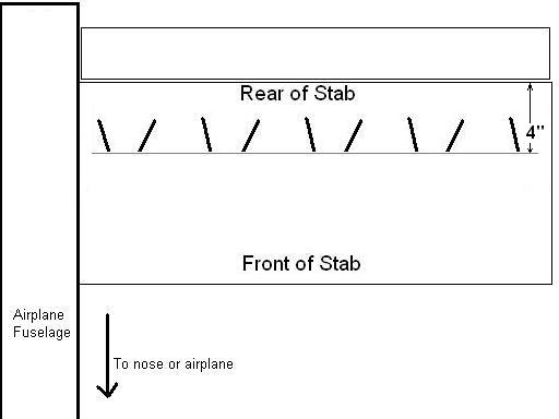

PostPosted: Sun Dec 13, 2009 5:00 pm    Post subject: Vortex Generators Reply with quote
Scott;
They go on the rear of the tail with the VGs 4" in front of the gap between the elevator and the stabilizer. Here is an image of where they go looking up at the tail. I only had 4 VGs left over when the job was completed. I will take a picture and post it on my web page. Remember, they go on the BOTTOM of the tail.
Galin

sstearns2(at)yahoo.com
PostPosted: Sun Dec 13, 2009 5:59 pm    Post subject: Vortex Generators Reply with quote
I made the elevator on my two place with an extra 2" of chord to get more pitch control. The VGs are a good idea too. That seems to me to be the perfect place for them.
Scott

galinhdz(at)gmail.com
PostPosted: Sun Dec 13, 2009 9:57 pm    Post subject: Vortex Generators Reply with quote
Mine was already built so I didn't have that option. Surprised)

I put the vortex generators on my Tr-1.
Big big difference! Wow , I now have elavator authority at slow speeds.
I was only able to do 4 touch and goes because of fog moving in, but I was able to land and stop in tthe first 1000 feet of runway for
The first time ever! I placed the leading edge of the generator 4 inches forward of the elevator gap. I have
The O320 engine configuration. More testing to come... Initial results are fantastic!

PostPosted: Mon Dec 21, 2009 12:23 pm    Post subject: Vortex Generators Reply with quote
Randy,
Do you have the original elevator size or did you build in the aprox 1" cord extension?
I have the extension and have plenty of elevator authority. On slow speed landings I run out of aileron control with a cross wind,
but still have plenty of elevator.
If I didn't have the extension I think I would try the Vortex Generators before rebuilding the elevator.
I also regularly use 'OC's' procedure of adding a little power on short final, to kill a high sink rate.
Tim
N52TY TR-1

PostPosted: Mon Dec 21, 2009 2:30 pm    Post subject: Vortex Generators Reply with quote
Yes I have the original elevator!

kentpyle(at)iland.net
PostPosted: Mon Dec 21, 2009 2:44 pm    Post subject: Vortex Generators Reply with quote
Randy, good news! I thought this was simpler than adding to the elevator cord. Kent
