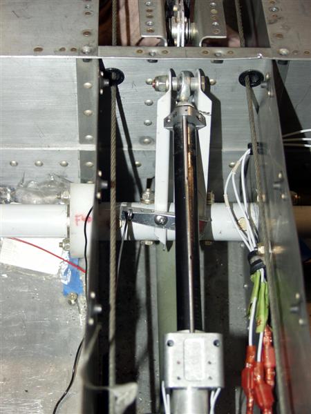

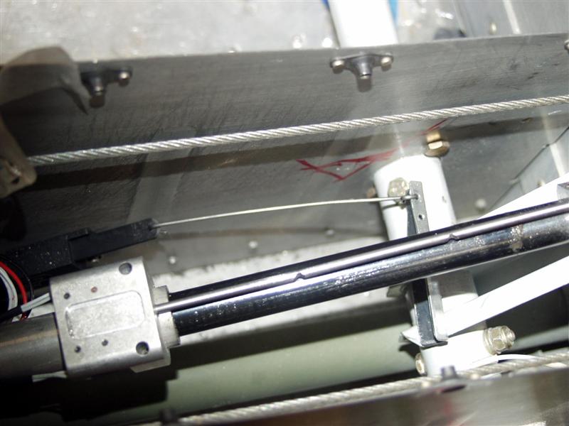

I don't know if this is what you are trying to address, but I've been meaning to post these pictures in case they help.
The Show Planes positioner places the flaps at preset 3 degrees up, even, half down and all the way down. The owner/pilot I'm helping wanted to be able to "see" the position of the flaps on his AFS monitor at night, so he got the slide resistor sensor that feeds into that (I'll get that info for you if you want it, don't have it with me, I think it is also by Show Planes).
The trick is to mount it in such a position that it gets full range of the flap without exceeding the limits of the sensor -- about 1.25 inches. I kept fiddling with it until I got it close, then made the little "arm" you see attached almost to the bottom of the horn. This way, the arm pivots on the screw so that it increases/decreases the radius of arch -- hence increases/decreases the fine adjustment of the throw on the sensor. I made the connecting rod out of hobby shop servo connecting rod. Double sided tape is a good idea for getting the sensor at the right height and angle -- I just fiddled with ours.
It was very difficult to drill that hole on the horn while it is installed because of the position and it is hardened -- broke more than one bit. If that is what you are dealing with before you install it, I think that is a smart thing to do! That pivot hole is as low as I could go and still get a nut on the backside where the flange comes into the hub.
Later, - Lew

Coming in on this mid stream but the position sensor is from Ray Allen Make a horn out of aluminum and attach it with a hose clamp. Get some 4-40 ball links and push rod from the hobby shop. Dubro sells a complete kit. Use it to tie the horn to the sensor. The exact amount of throw is set by the height of the attach point on the horn...lower less throw, higher more throw...as Lew said...little fiddling and you'll get it perfect. Years of building R/C aircraft made this a no brainier for me...I'll bet Ivan and Geoff breezed past this too!!

If you are using the Vertical Power (VP-200) you will need the Ray Allen Pos-12 sensor. In speaking to Marc Ausman of Vertical Power he tells me to use only one inch of the available 1.25" of travel and then center this one inch of travel in the overall travel as near the ends the sensor is not very accurate.
As rick accurately pointed out, years of experience in R/C modeling made this an easy install. Go to your local hobby shop and get some 6-32 threaded rod, a 6-32 quick link for the sensor end and a 6-32 ball link for the other end.
Unfortunately I am away right now and don't have access to the computer with all the pictures I have of this install but if you are interested the PM me and I will send you some when I get back.
