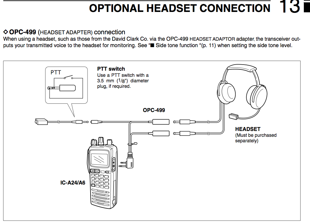

Tony,
Maybe I'm misunderstanding your intention but I have the Icom A6 adapters for headset, external power etc and use the PTT on the joystick without any modification to the PTT switch on the A6.

PostPosted: Mon Jan 18, 2010 7:11 am    Post subject: Re: Icom A6 PTT wiring Reply with quote
The problem is that ultralight helmets only have the one cable for both intercom and headset so there are 5 wires. The stick grip I bought only has the one NO switch for intercom. Just wondering if there is a way I can still utilize the one button on the grip without having to go back to using the velcro attached button that has the two switches in it.

PostPosted: Mon Jan 18, 2010 7:34 am    Post subject: Icom A6 PTT wiring Reply with quote
At 10:11 AM 1/18/2010, albertakolbmk3 wrote:
--> Kolb-List message posted by: "albertakolbmk3" <cheriebraun(at)xplornet.com>
Does the NC switch turn on the intercom when the radio's not transmitting? If so, you could wire the NO button on the stick to work a relay that has both NC and NO contacts, and the relay switches the radio and intercom.
