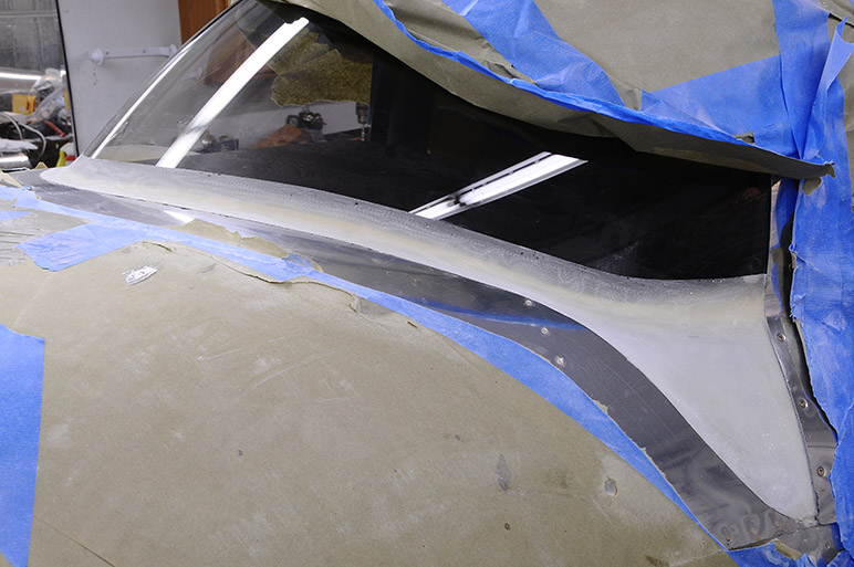

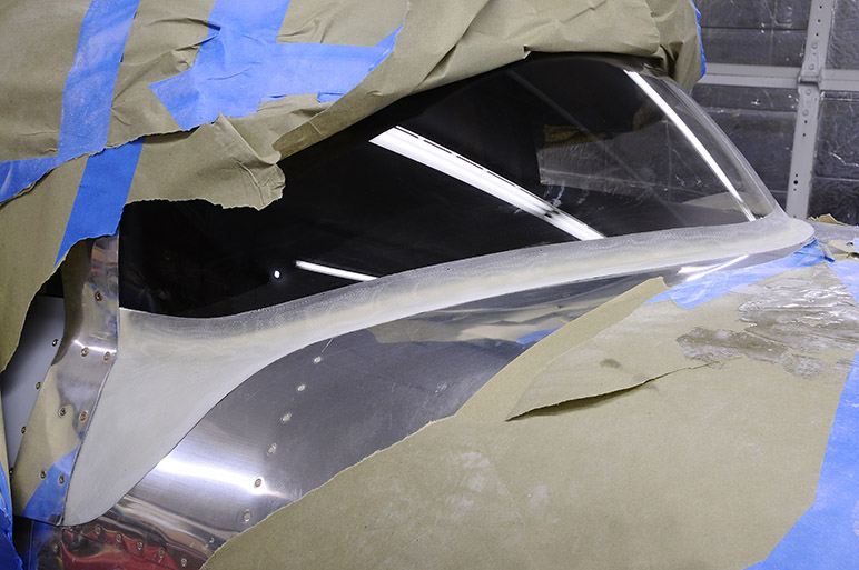

I've been working hard on the front, fixed fairing around the windscreen this week. Literally, I've been dreading this job more than ANY other on this project. Tonight I sanded though the first layer of electrical tape and in one little spot the second layer started to come up, so I had to pull all of the electrical tape off and so I was able to check out the actual fiberglass fairing after two days of sanding! Yahoo! It came out nearly perfect!! Not bad for creating a fairing out of nothing! The process described in the manual really does work amazingly well. I followed it to the tee up to this point.
Now I have to retape everything, add a layer of resin mixed with filler, then final sand the whole thing. Should be pretty straight forward, but a couple of days worth of work.

Hey Matt - the fairing looks great.
I'm assuming you lay it up with tape under so you can remove it and clean up both the top and bottom edges then glue in place on the fuse and windscreen? Am I correct?

Hi Ken,
No, per the instructions, the fairing is bonded right to the plexi and the top of the fuselage. The multi-layer electrical tape trick gives you a really nice edge on the plexi, and you sand the fuselage edge down to nothing for a feathered edge. Using this technique, it would seem that you can come up with a much thinner and lighter fairing. If it had to be removable, it would have to be 4 or 5 times thicker particularly at the edges. I think.

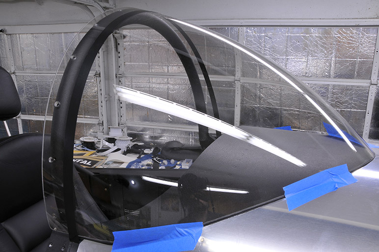

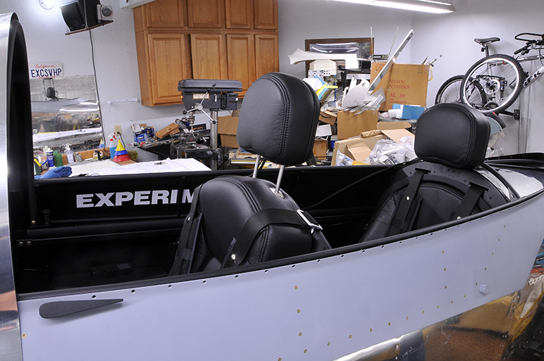

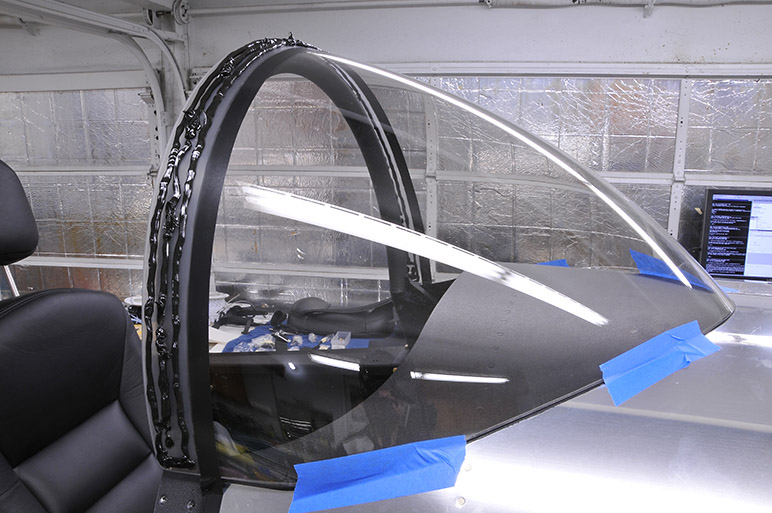

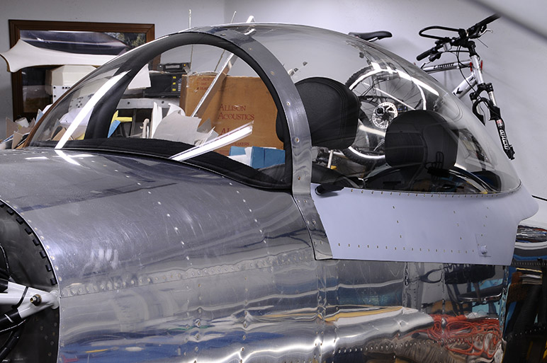

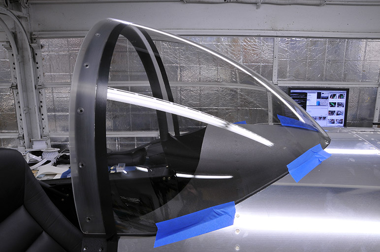

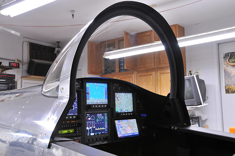

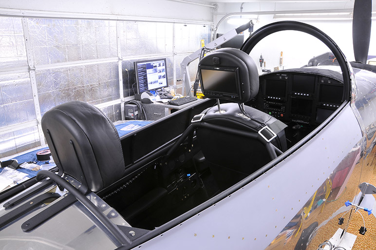

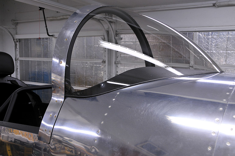

I went a little different way on the windscreen. I fashioned a .032 metal bezel up and over the top of the roll bar. Its about 2.5" wide. It worked out really nice because I was able to powder coat the underside of it before I assembled everything. Plus, I didn't have to get all of the sanding dust inside the plane! So, the fiberglass fairing only has to go around the front of the windscreen and then butt up against the metal fairing. Much easier. I'm not even sure how I would have done a fiberglass lay up over the top of the roll bar. The canopy skirts fit underneath the metal bezel that goes over the roll bar. So does the first 3/4" of the canopy too.
As far as the sliding canopy, I opted to use AN rivnuts and #6 screws all the way around. Worked good. Canopy replacement in the future should be pretty easy - not that I want to, mind you. But, since I cracked the first one - just as it was finished - I'm for anything that will ease the future removal/installation since the screws made installing the second on much easier.
I've attached a few pictures for your viewing pleasure...
