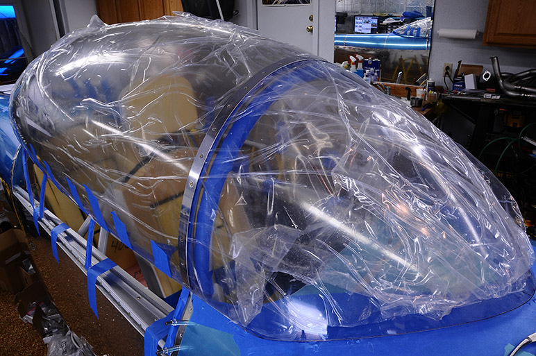

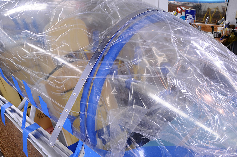

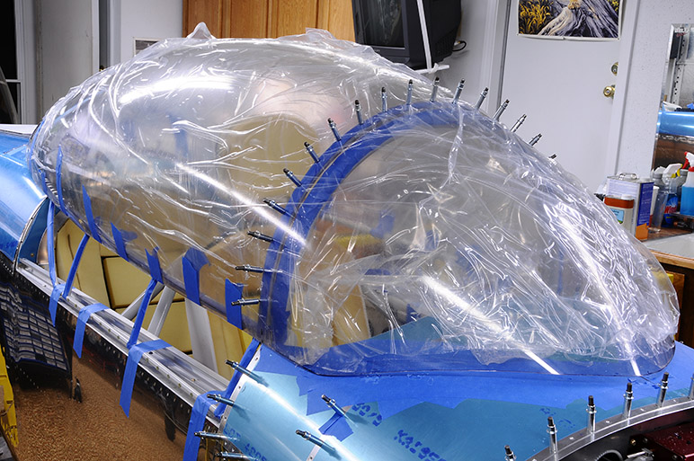

Looks really nice Matt:
Isint the fairing supposed to go OVER the canopy skirt though? They may have changed it since my first 8. I am getting close to doing this as well. Got any good pics of the canopy fit up and cut?
Did you bond your canopy or screws?
AL Grajek

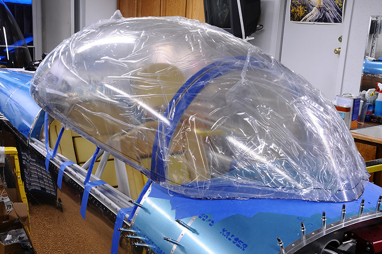

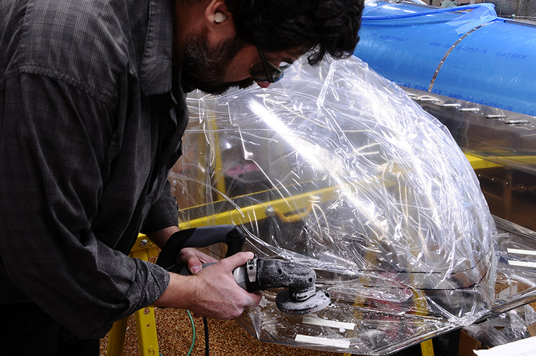

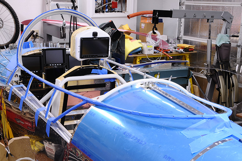

Here are a few (!) pictures of the canopy installation (second time around).
Matt

Thanks for all the great photos Matt!
They will be a big help. How do you decide HOW MUCH to trim at the front. I see your line is about an inch wide. I was thinking of just trimming little by little till it fit( lot of work).
Al

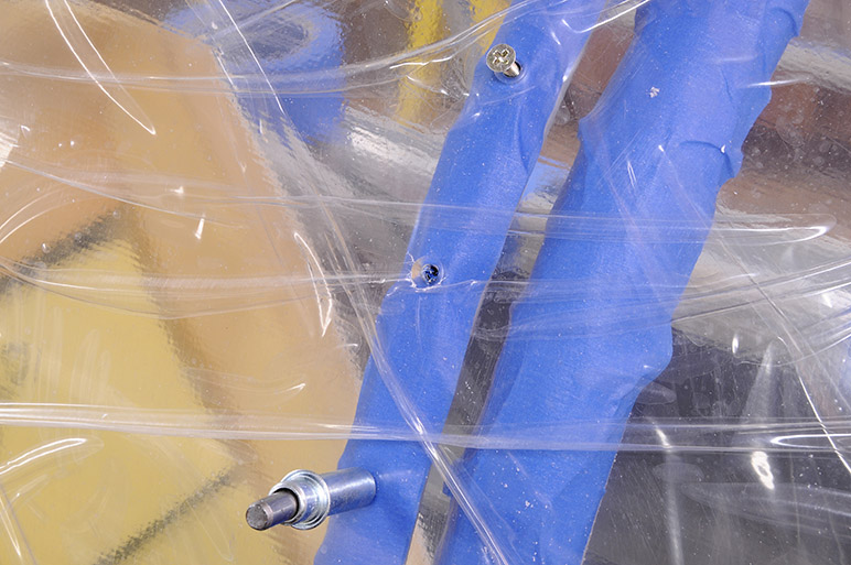

Well, on the second canopy I kind of cheated. I just used the first one and measured all the way round plus about .5". You're right, though, in that basically you just start cutting a little bit at a time until you finally get to the right amount. I think I took the canopy on/off about 8 times with 8 cuts to finally get to the right length. Here's my log entry on the original canopy fitting (10 log entries) starting here:
http://www.mykitlog.com/users/display_log.php?user=MattsRV8&project=638&category 973&log=67122&row 54
Definitely use the AN version of those rivnuts, though. ACS has them. Those Stanley versions I show in Part 08 are shit.
Matt
