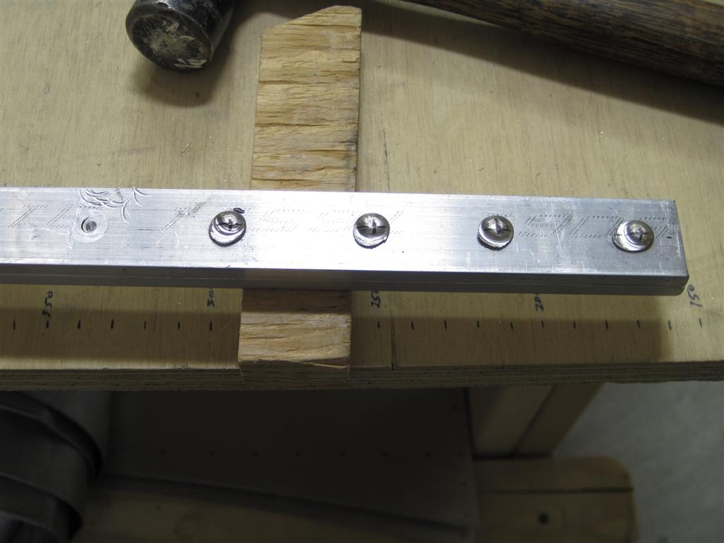

My problem is driving the big rivets w/o mangling the manufactured heads.
The jury is still out, but my practice efforts are pathetic. See attached
photo. I'm sure glad it's not on my spar.

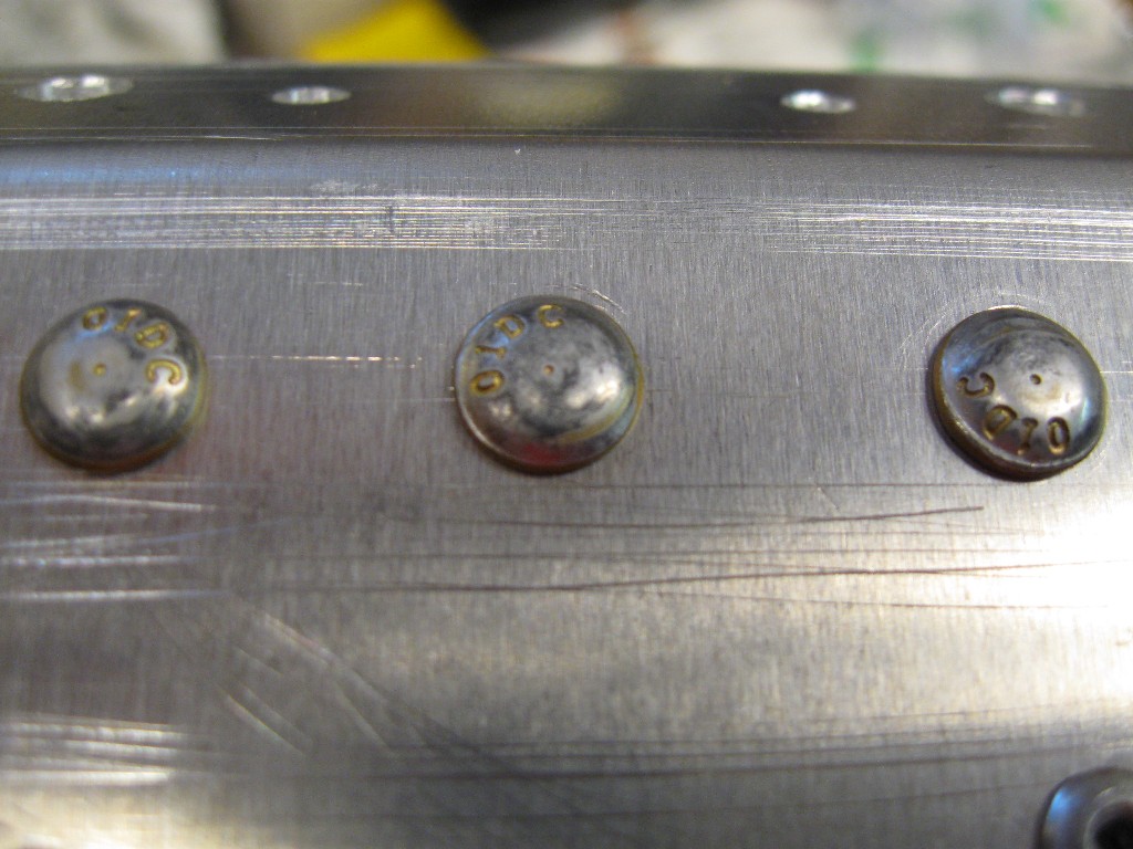

The only advice I can offer is this:
- FIRM pressure on the rivet gun against the manufacture head. Do not let off on the gun pressure until after you let off on the trigger.
- Hold the gun very perpendicular. Don't eye the shop head during the squeeze, keep attention of the rivet gun side.
- Use a fairly high air pressure. I used 90 psi for the -6's and like 70 for the -5's. You need to get to the point where you can drive a good rivet in around a second of trigger squeeze. Milking them at lower pressure only makes a bad rivet.
- Practice makes perfect. Rivets are cheap, keep on bucking!
Here is my end result on the center spar. A few cosmetic edge marks are present on the rivet heads and they are acceptable.

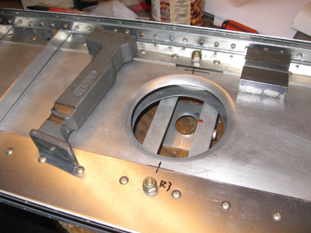

PostPosted: Tue Feb 09, 2010 4:25 am    Post subject: Re: rivet sets Reply with quote
For most of my rivets, I used the rivet set that is on the left of the attached picture. I bought it from Aircraft Spruce. I think it weighs a couple pounds. For the center spar top rivets, it was a little tight getting to the underside shop heads. I grabbed a piece of steel I had laying in the shop and it worked great. It only weighs a 1/2 pound or so. It is on the right side of the picture. I did have to hold it a lot tighter since it was lighter.

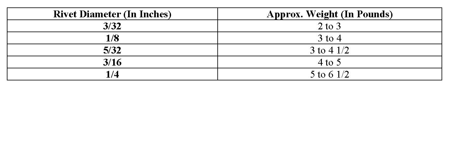

Here is a chart of rivet size to bucking bar weight. With the right size gun, bucking bar and the right air pressure it should take 3 to 5 strokes of the gun to form the shop head. It looks like you are driving it way too long.
You need to get comfortable hitting them hard and quick. Assuming you have the correct size set that should work.

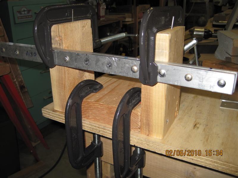

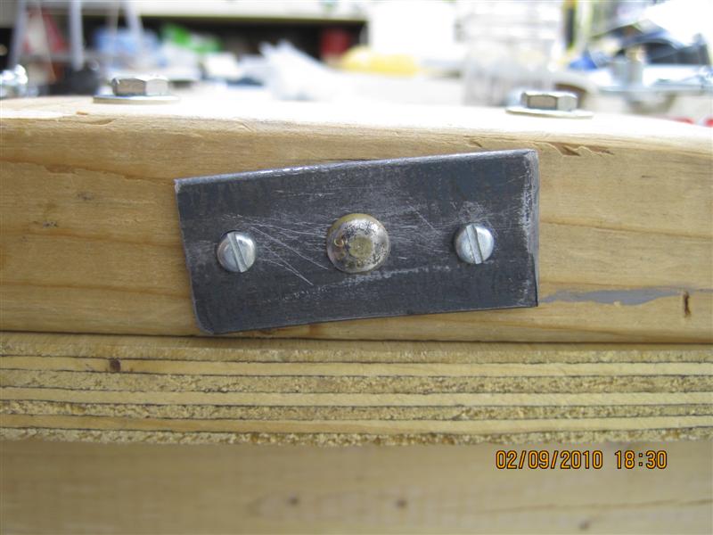

Many, many thanks to all who responded. I think I'm seeing light at the end of the tunnel.
Post Mortem: I believe that I had a combination of factors fouling up my riveting.
  • As Jeff says, it is vital that the piece be securely fixed. I thought I had done this with the jig, as shown in the photo 409. But I think that I was wrong. I now believe that the structure probably rocked backward with every blow from rivet gun, but the dynamics were such that the next rivet gun blow struck before the rivet rocked back under the set. The reult was a smashing of the bottom of the mfg'd rivet head.
  • In trying to keep control of the rivet gun with one hand while I held the bucking bar with the other, I found that by reducing the air pressure to ~50 psi, I had better luck keeping the gun on the rivet.
  • But, at this low pressure, my "well used" 3X gun probably required at least 5 seconds (and way too many impacts) to form the shop head. After 5 seconds of pounding, the mfg's head softened from compressive heating, and deformed easily (I produced some really awful mfg'd heads)!. It was probably impossible to drive the 3/16 rivets reliably with this low pressure because it just took too long.
  • And, it required more skill that I have to hold the rivet gun steady in one hand and the bucking bar in the other while driving the rivet, so the rivet set moved around and obliterated the mfg'd head.
Pretty grim. So, I have made a much simpler jig to hole the practice bar, just 2-2x4's with a slot on the edge to clear the rivets, bolted to the edge of my table. With this design, there is negligible lever arm to flex and bend under the rivet gun impact, see photo 415. My helper was not available today, so, for practice, I screwed a piece of 1/8" x 1" steel scrap to the back edge of the 2x4 with a 3/16" hole for a rivet, also shown in photo 415. Then I could put a rivet through the hole and practice riveting with full compressor pressure.
It was fairly easy to hold the rivet gun in place with both hands and avoid mangling the mfg'd head. If I kept pounding long enough, the head would soften and deform. The force of the rivet gun was easily enough to drive the steel into the 2x4, resulting in a significant bend in the metal after a while.
When my helper returns tomorrow, I'll try the new practice setup on the practice bar.
