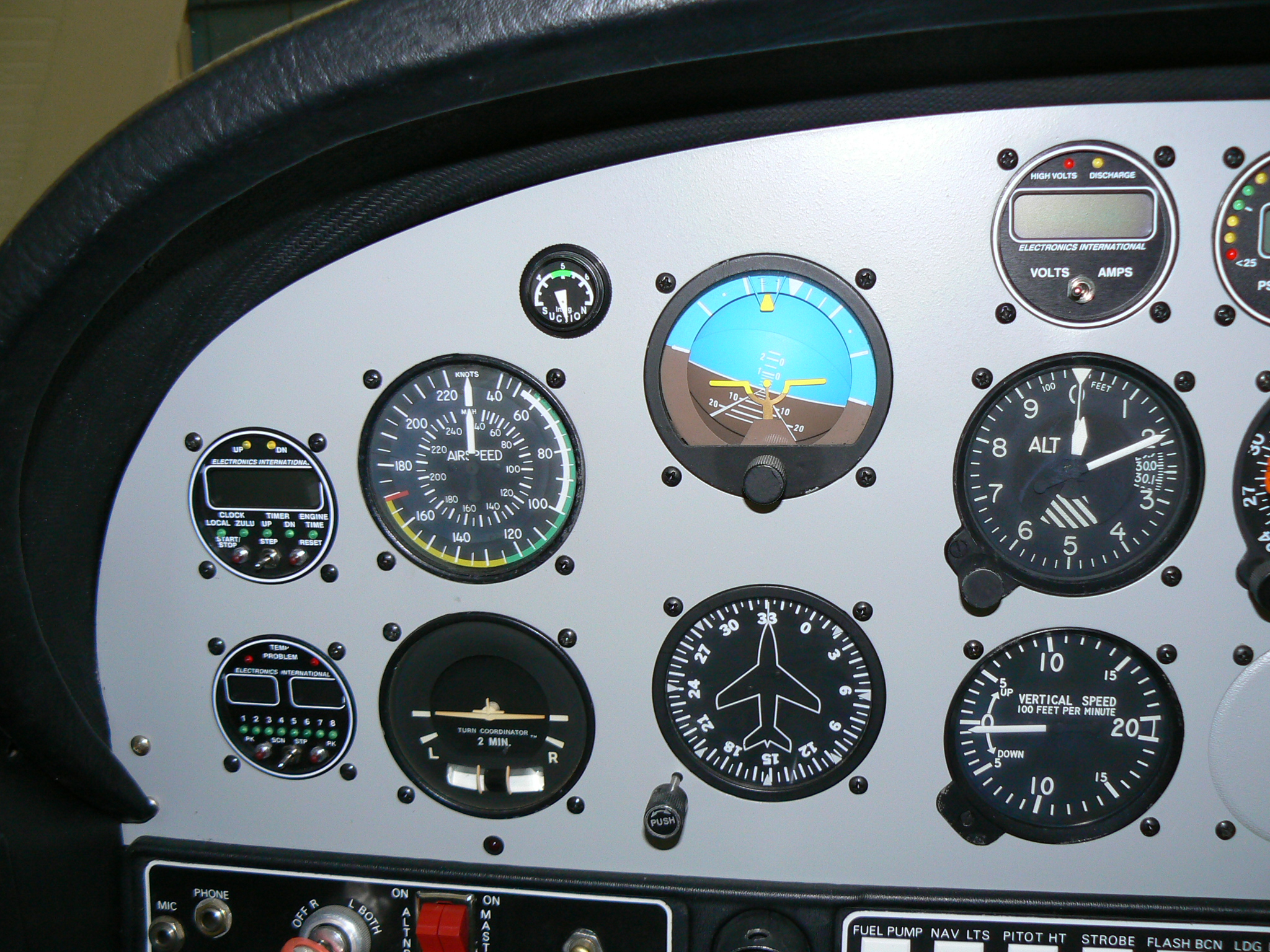

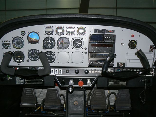

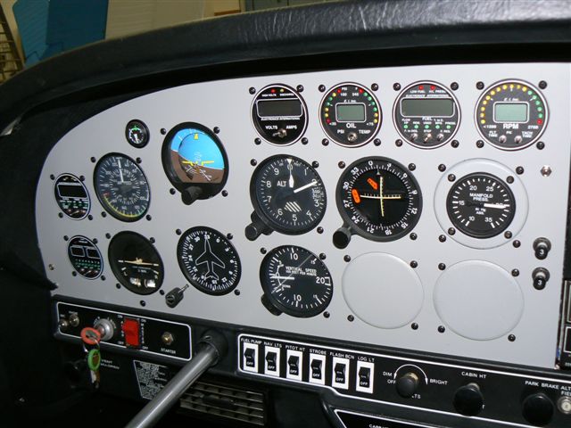

Here are a couple of photos of the panel on my Lynx which I did about 4 years ago using Gary's eyebrow.

Real nice Cliff. I like the EI gauges. Is your altimeter crystal cracked?

I think you mean the VSI? I think that is some odd light reflection. Here is another photo of it.
Cliff

If I was doing it over again I might use the Mitchell instruments as they are much cheaper and take up a lot less panel space. I do like the accuracy of the EI instruments and having a volt and ammeter in the same instrument as well as oil pressure and temperature. The FP-5L is the primary one so that fuel pressure is shown on that instrument. Adding the EI instruments at the top of the standard panel was only possible because of Gary's eyebrow which angles up so that you can now see clear to the top of the panel (a very nice mod). A full length light strip is hidden up under the lip of the eyebrow and floods the entire panel.
Note that I have a separate analog voltmeter on the RH side which is tied in to an emergency buss.
