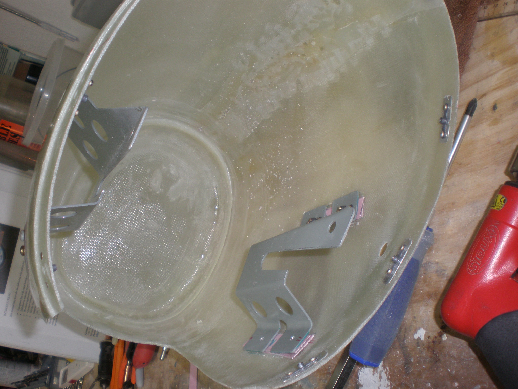

Posted: Sun Feb 28, 2010 9:05 am Post subject: Reinforcing screw holes on wheel pants |
I shoved some pieces of GRP that I had cut off of the doors (window) under the screw holes (epoxy/flox glue) and they are tight and tough.
