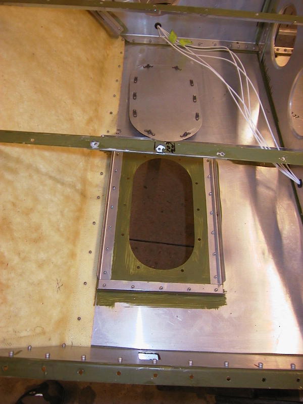

Bob,
I made wingtip inspection panels when I originally built my 601 to access the strobe packs. I guess I will be able to also get to the counter-weight bolts to remove ailerons.
Dave

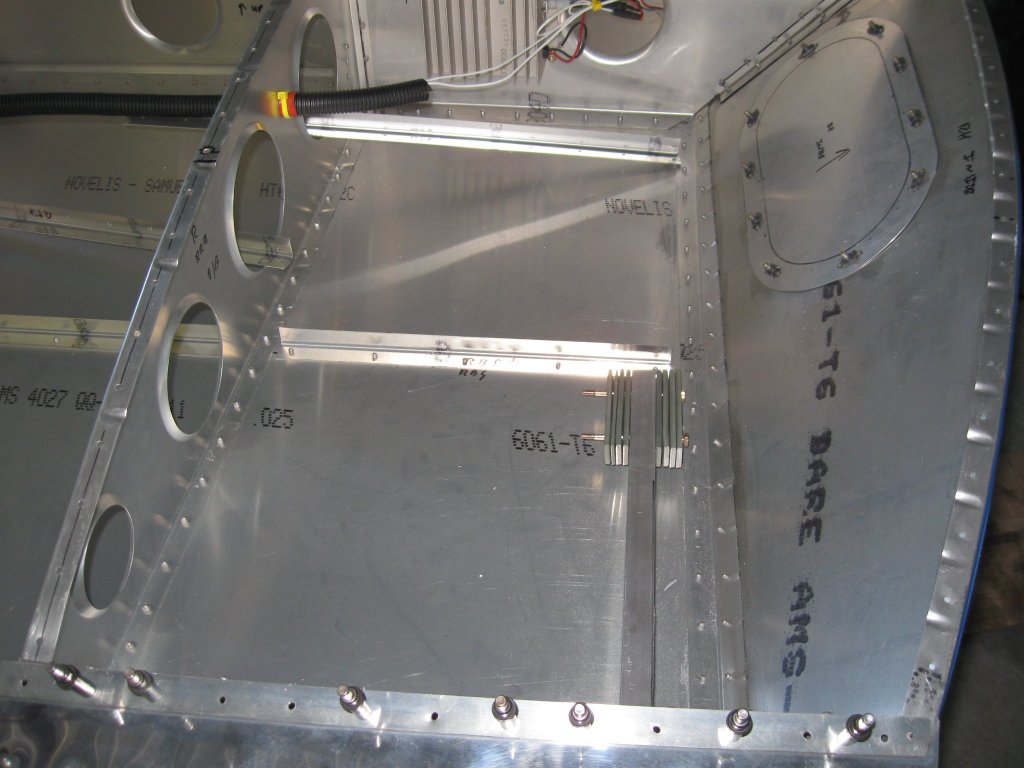

I did put an access hole under the aileron balance weights. It is 110mm x 220mm which is large enough for me to remove the weights to install or remove the weights. Also, a good idea to use lead and fewer plates so they can fit through a larger hole in the rear spar. Maybe a doubler around the larger hole would be advisable.
