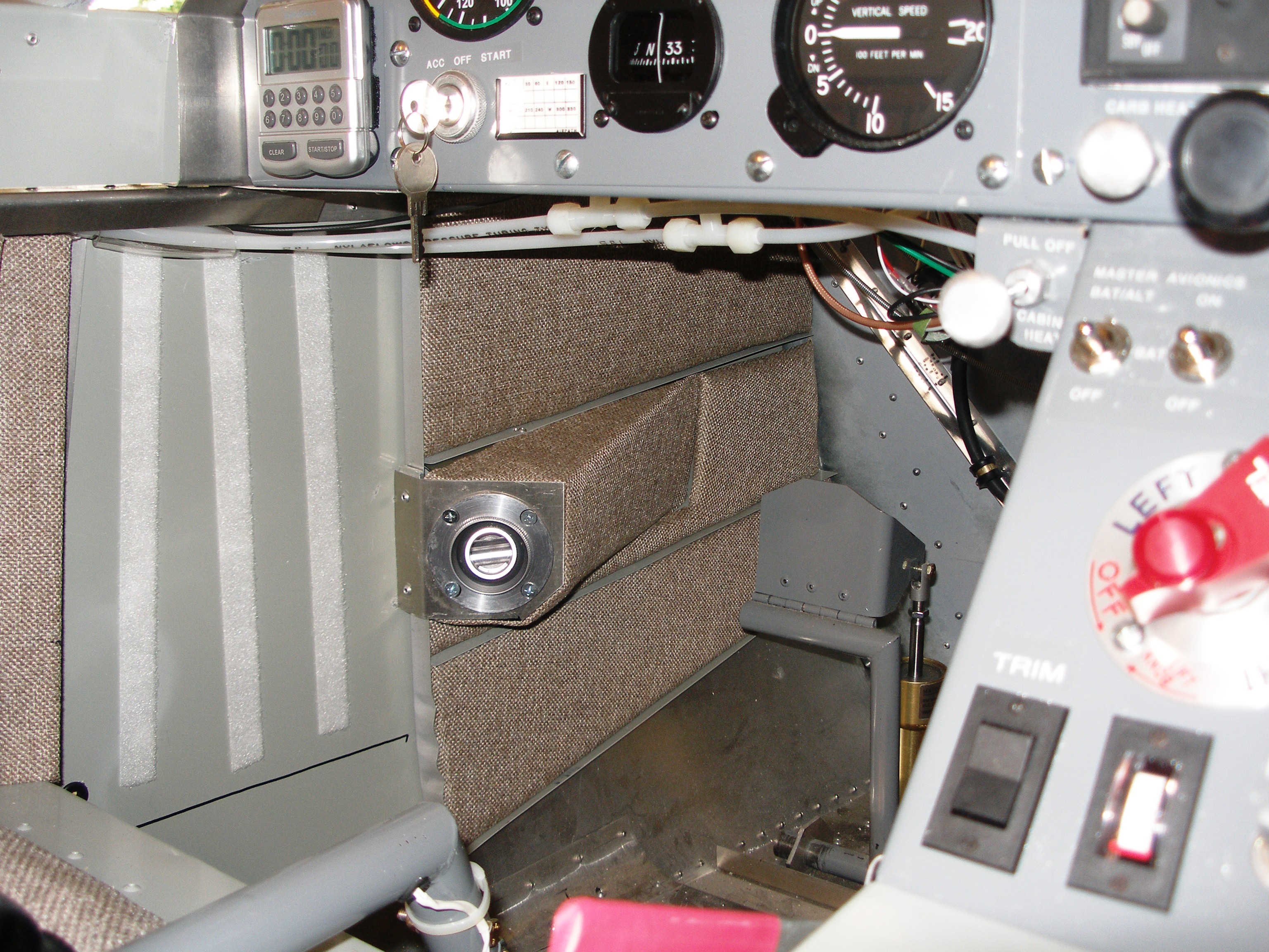

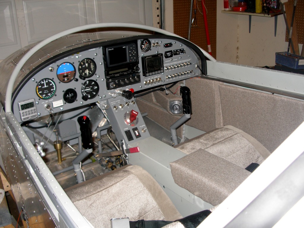

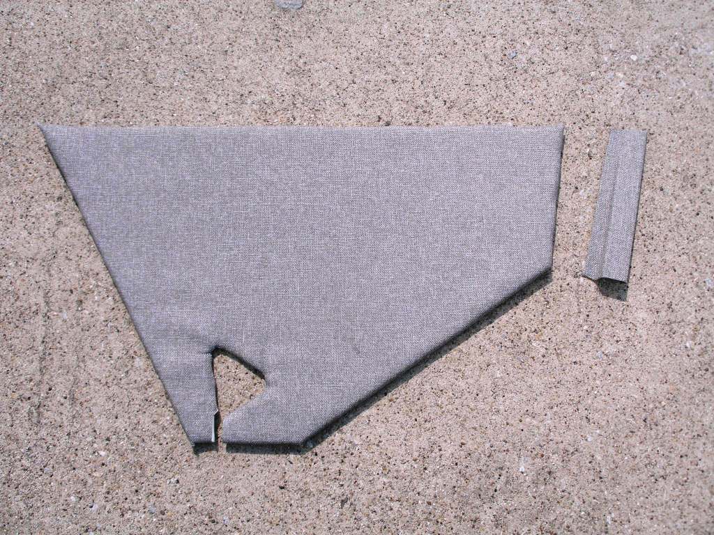

James,
I made upholstery panels with an aircraft grade plastic corrugated board covered with a thin aircraft grade foam sheet and fabric, all from Airtex (Airtexinteriors.com). I added vertical strips of L angle to the fuselage upright angles and placed strips of Velcro on those angles and horizontal strips of Velcro on the panels. It was very easy to install and they are easily removable for access to "stuff" that is behind them.  On the forward panels, I placed the Velcro directly on the inside of the fuselage skin and filled in between the angles with fabric panels. Questions?
Jay Bannister

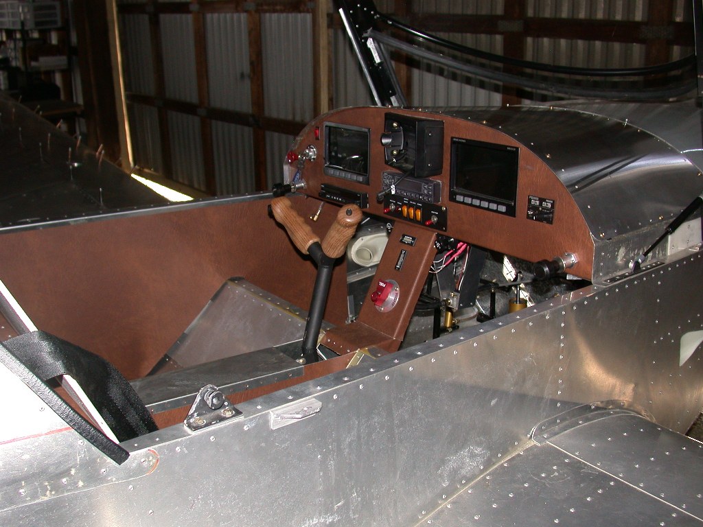

PostPosted: Sat Mar 20, 2010 4:34 pm    Post subject: Cabin fittings Reply with quote
Here is another idea. I used some extra 6061 to make the side panels. Then
I glued Naugahyde to the aluminum. The panels are held on with Velcro for
easy removal and tucked up under the upper longeron cap. Picture attached.
